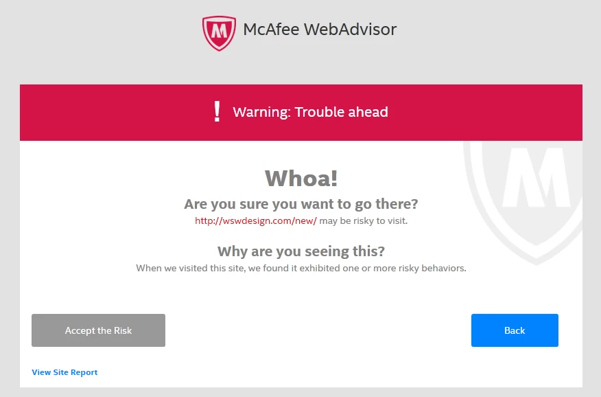

Yes there is nothing wrong with the site. I contacted McAfee to rescan and correct the issue but of course not fixed yet.
Nancy OShea
Jan 8, 2017 10:56 PM UTC
Ummmm......  you've got bigger problems. Sorry to say I'm not willing to risk it.  You better find out what's throwing up red flags on your site and correct the problem ASAP.
BenPleysier
Jan 8, 2017 11:02 PM UTC
An overly zealous McAfee. There is nothing dubious in the site.
