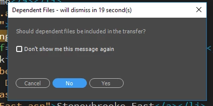

    John, the annoying pop-ups decreased by turning off automatic up-date to iis test server in DW as you suggested.  I’m just getting one pop up (below) every time I “open” an asp file from this site; even when starting DW after it was shut down.

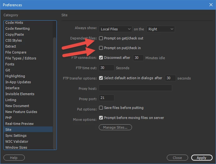

    BenPleysier
    Jan 14, 2018 1:08 AM UTC
    Go to Edit -> Preferences and make sure that the relevant features are not checked as in

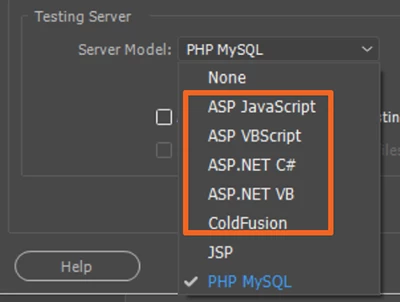

    When you say "looks different," we don't know what that means.  Maybe a few screenshots would help us better understand the problem.   Based on what little info you've provided, I'd say your testing server is not defined correctly.
    I keep my local site folder in my testing server's default web directory.  Keep in mind that I use Linux/Apache servers, not Win IIs so my screenshots are different from yours.  But the idea is still the same.   When I save any local file it's automatically saved on the local testing server because that's where it permanently resides.
    Servers > Basic Tab
    Servers > Advanced tab
    Your server model will likely be one of the ASP options.
