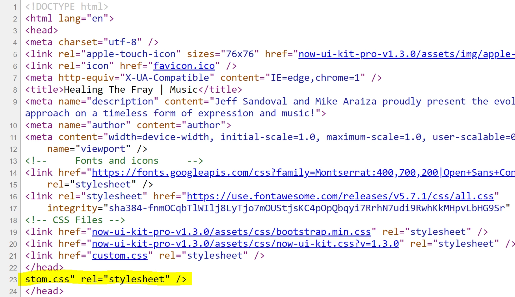

I am making a site and keep running into this issue. When I upload to the host (GoDaddy) this random extra text gets added. I am at a loss as to why this happens.
Here is what I am uploading:
But..
this is what ends up on the site
I have no idea what is happening any advice is appreciated

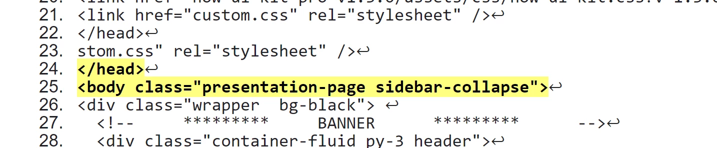

Bryant Designs
Nov 11, 2019 8:41 PM UTC
Issue 4-5 is the problem. I am not sure what is happening on the transfer because my source code does not have the extra closing head tag.
Line23, 24 do not exist in my code.
This is exactly what I am uploading to the server.
It is adding things to my code that I have no explanation for?

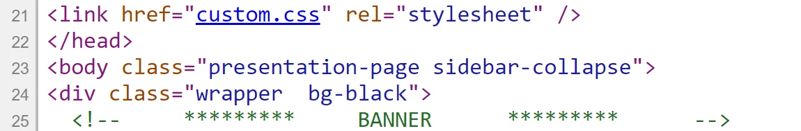

Bryant Designs
Nov 11, 2019 6:28 PM UTC
Same code as DW

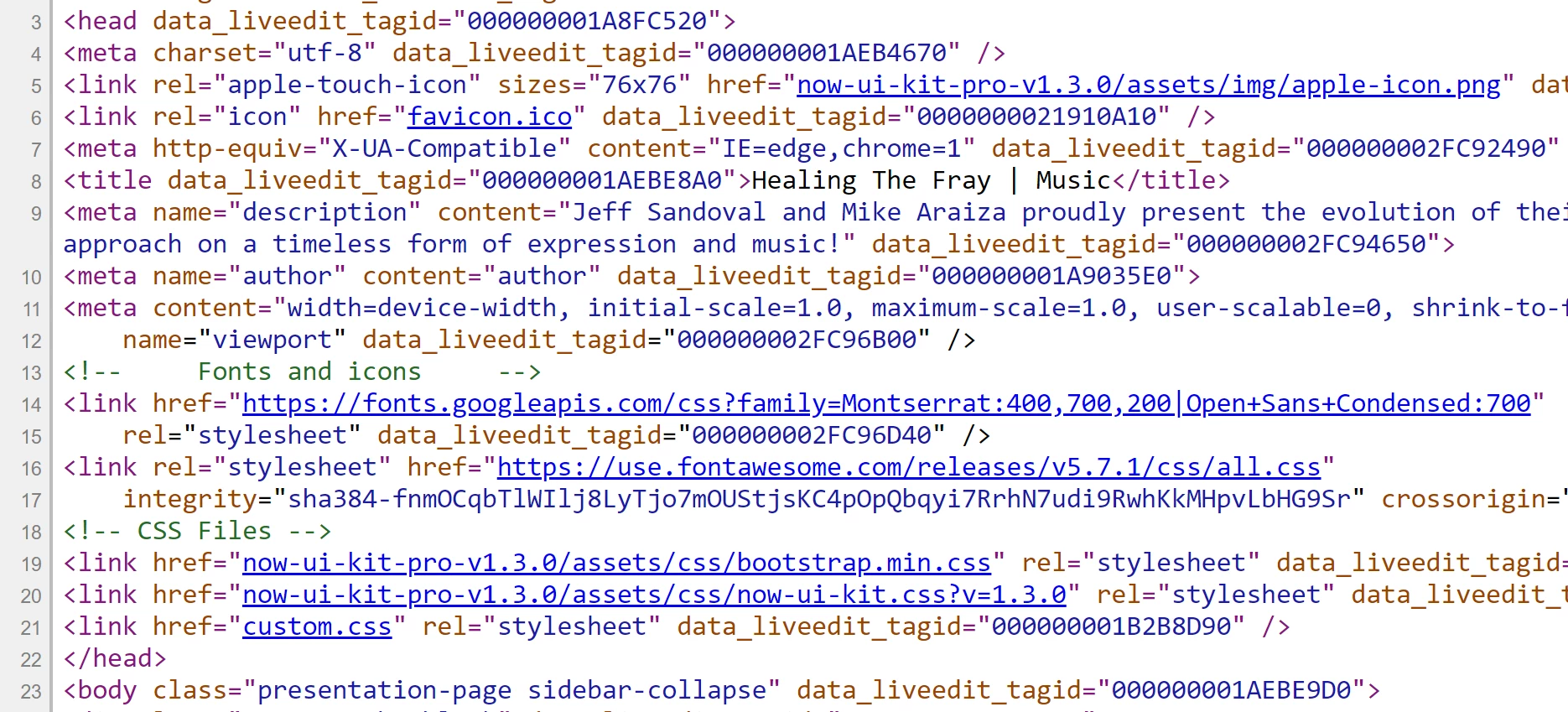

They all look the same to me, DW, VS Code, Brackets, apart from the very first screen shot which as has already been pointed out is something DW injects into your code for live viewing. That however won't get transfered to your server along with the page. So what exactly is it that is incorrect with your code, disregarding the injected code, which only gets used inside DW.
B i r n o u
Nov 11, 2019 5:58 PM UTC
it seems that you are viewing the live code (the one used by DW to render content in live view mode) and not the HTML code of the page itself
so the one that is transferred seems to be correct, the other is only the one generated by DW internally in order to allow both visualization and editing in real time

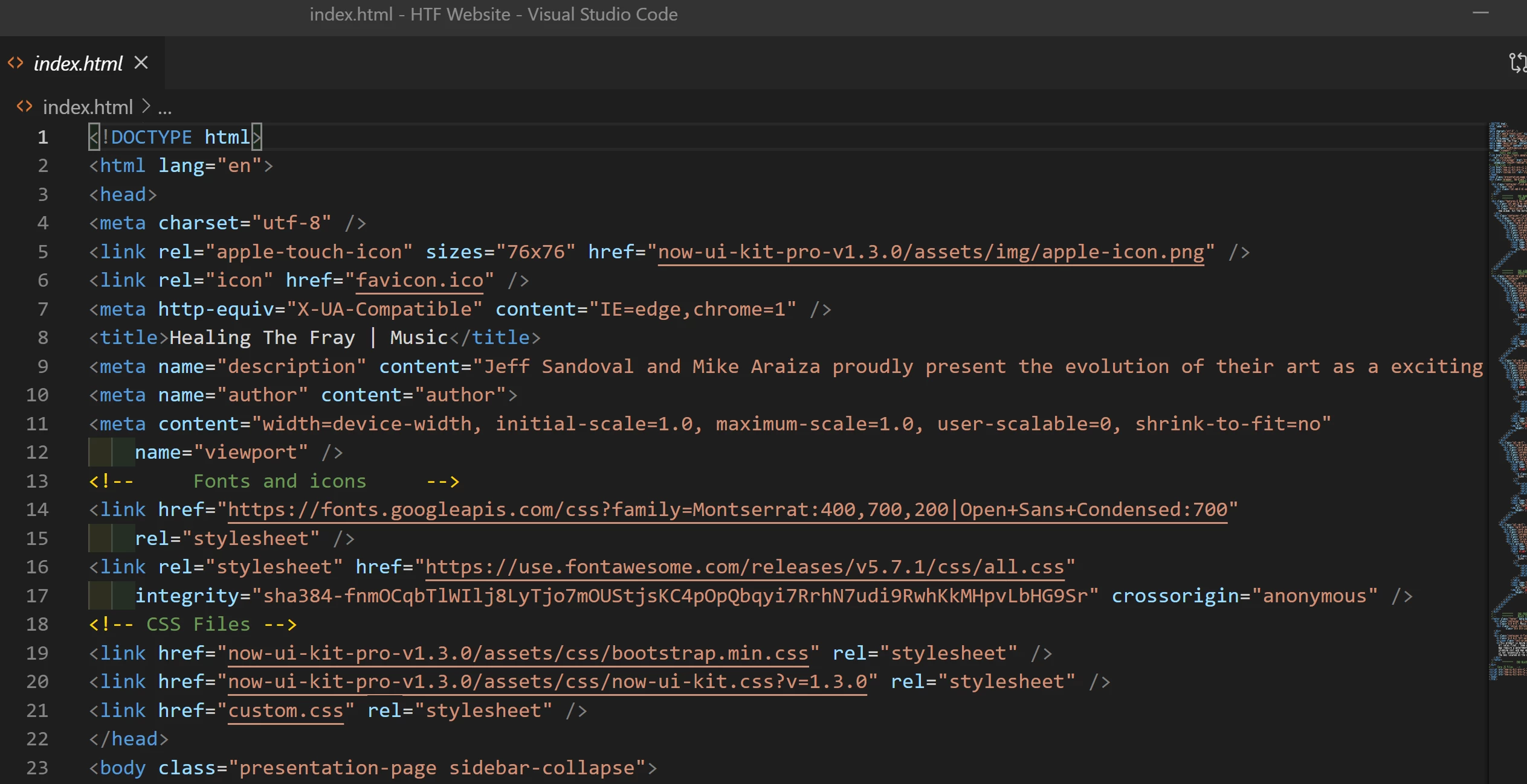

Bryant Designs
Nov 11, 2019 6:29 PM UTC
Yea I only did that because it was giving me an error when I used a screenshot right from dreamweaver.
This is the exact code I am uploading opened in VS Code
