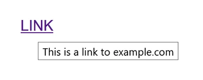

What you want are called tooltips.
The simplest way to make a tooltip is with the TITLE attribute.
<a href="https://example.com" title="This is a link to example.com">LINK</a>
For fancier tooltips, see links below.
I don't recommend using Image Maps in responsive layouts.  The hotspot coordinates invariably fall out of register when image is re-scaled.   A safer approach is to use separate images, buttons or text links.
