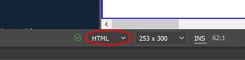

Nancy OShea
Jan 23, 2019 7:55 PM UTC
Try switching to HTML from the document type drop list.  See screenshot.  Then try Emmet shortcodes.
