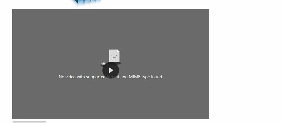

I am not sure if my problem is in Dreamweaver or Premiere Pro. I set up an html page to play video directly off of my website. When I check the Real Time Preview in Dreamweaver, it works perfect in the Firefox Browser and Opera Browser. For some reason, it is not working in the Microsoft Edge Browser and Internet Explorer Browser.
However, the main issue is that when I loaded the files up to my website, the videos do not appear on any of the browsers. I get the following where the video should be:
"No video with supported format and mime type found"

I am using a script to display several videos. I figured that maybe the script was creating the problem. So I did a test page without the script and got this:
And I still get the same message. Not sure what I am doing wrong. My video files are in MP4 format. I thought that maybe they need to be in OGV/OGG or webM format. However, I could not figure out how to export the mp4 file in Premiere Pro to any of those formats.

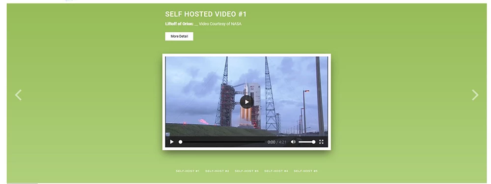

This is how it should look:
I figured I would start in this forum and see where I need to go from here. I just need some guidance on where I can find out how to correct the problem.

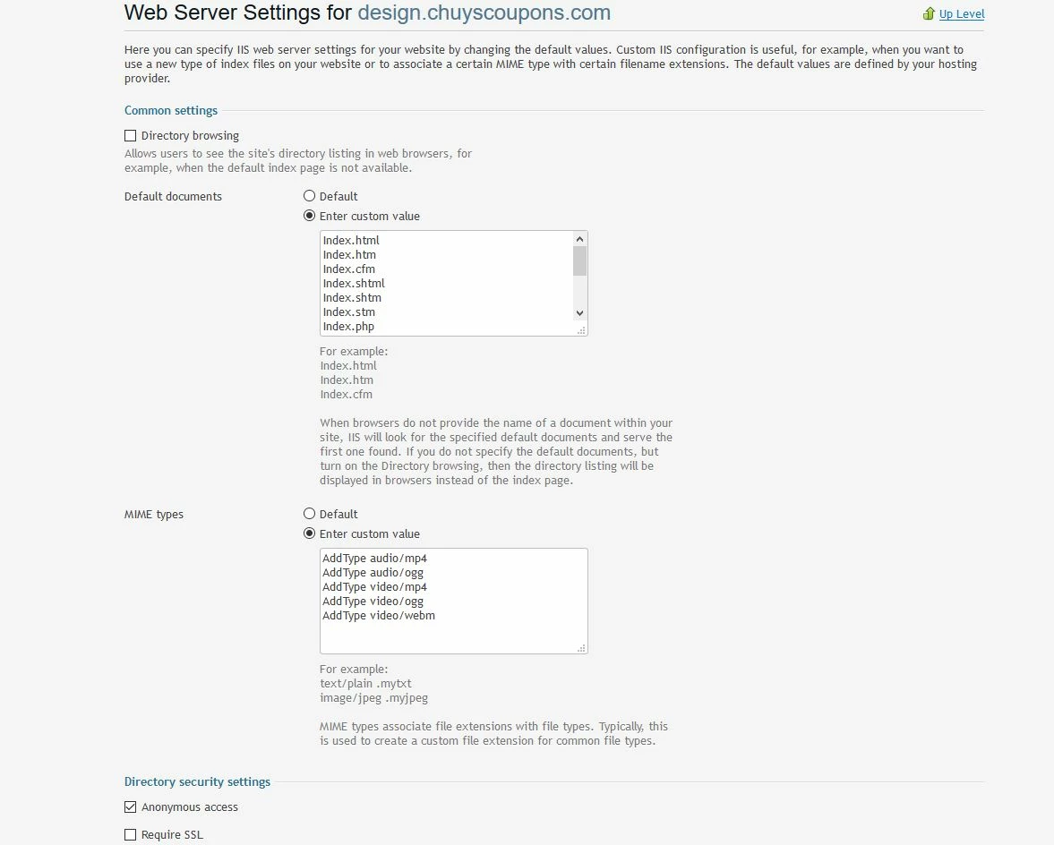

    Just wanted to get back to all of you on this thread to let you know I corrected the problem and my self-hosted video page works now! It turned out to be a server side mime type issue after all. I originally set up my server with this:
    AddType video/mp4 mp4 m4v
    AddType audio/mp4 m4a
    AddType video/ogg ogv
    AddType audio/ogg ogg oga
    AddType video/webm webm
    One of the examples I found on MDN showed an extension file like:
    .mp4, .webm, .ogg
    So I modified the mime type to this:
    audio/mp4 .mp4
    audio/ogg .ogg
    video/mp4 .mp4
    video/ogg .ogg
    video/webm .webm
    And that worked. Just wanted to thank all of you that helped me on this thread. You all helped me realize that it was a server side issue and not my code. Thanks Birgit, hans-g, John Fritz II, Nancy and osgood.

    Well, if you're using the HTML5 <video> tag, along with MP4, you "should" be fine. All major browsers now see MP4 without the need for the back-up file types WebM or OGV.
    If your server isn't configured to handle the MP4 MIME Type, that could cause the error you're seeing.
    If your code is clean and valid (which would mean it's not the cause of your issues), adding the following to the end of your .htaccess file in the site root may fix it...
    Jan 4, 2018 8:17 PM UTC
    Hello Jon Fritz II,
    Thanks for your reply. I am strongly agreeing with your solution. For some reason, I am thinking the Mime's allowed on my server were the problem. I went to my server and entered the mime settings you provided. My server accepted the settings, but it still did not work. Here is a pic of what I did:
    Thanks for your response. I will keep trying to figure this out.

    Jan 4, 2018 8:19 PM UTC
    I don't see any reference to mp4 in your code.   I see a webm file and your server doesn't support that MIME type.   See screenshot.   Follow Jon's advice in Reply #4.  Add the media MIME types to your .htaccess file and upload to server.
