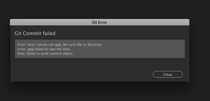

Also, when trying to commit from the git panel within Dreamweaver, I get the following error:
"Git Commit Failed -
Error: fatal: cannot run gpg:  No such file or directory
error: gpg failed to sign the data
fatal: failed to write commit object"

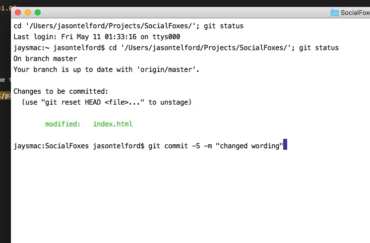

However, if I open the Terminal (I can do this either by manually opening Terminal and navigating to the git repo or by clicking the Terminal button from the git panel in Dreamweaver) and manually run the command to sign my commit

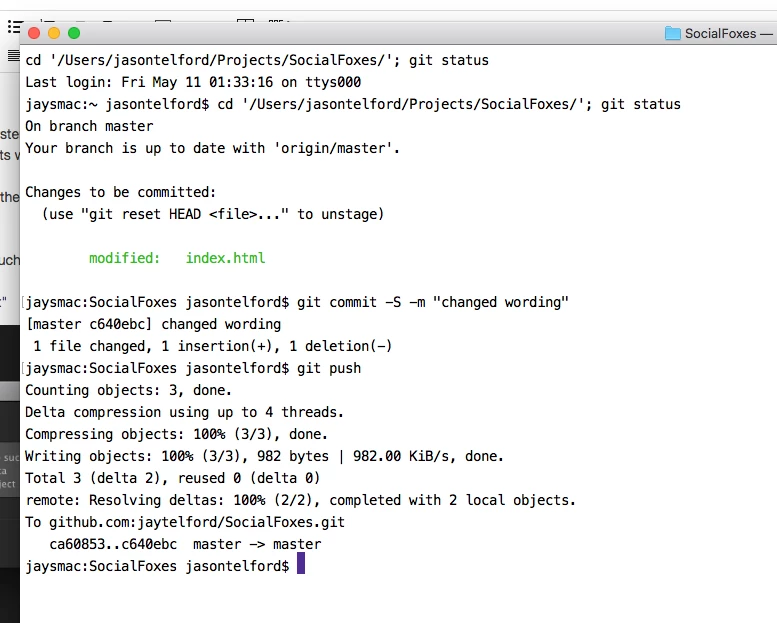

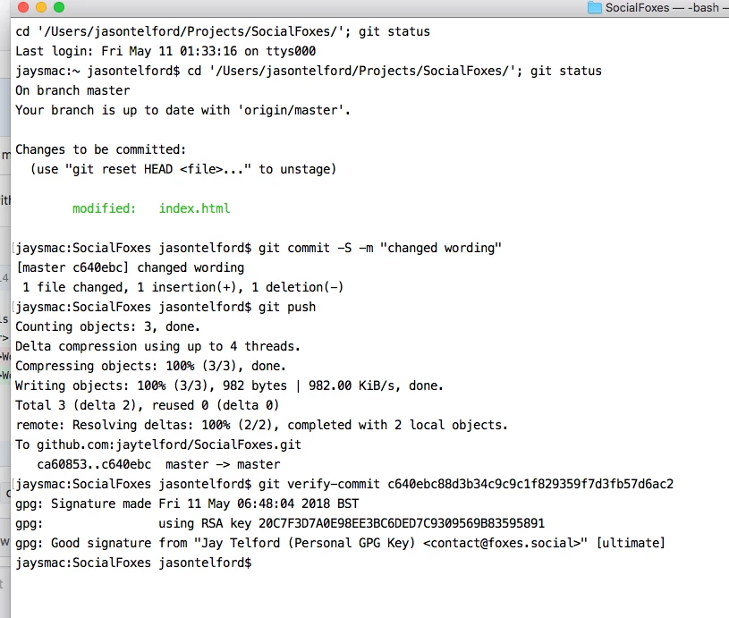

the commit goes through perfectly fine and is correctly signed.  The proof of this is in the screenshots below:
and you can now see that my commit has been signed correctly

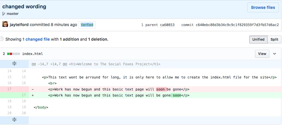

and on GitHub we see that the commit has been verified
Having just proven that I have my GPG keys set up correctly and that they ARE working, why does the commit fail if I try to do it using the commit button on the git panel inside of dreamweaver?  Is there a way that I can fix this?
