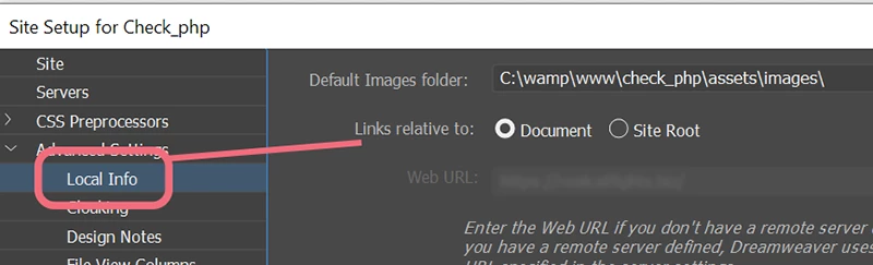

    If you let DW do it, it should work correctly with document relative link paths both locally and on the remote server.  Did you change the settings in your site definition as shown in my screenshot on May 28th?

    May 28, 2021 11:21 PM UTC
    Document relative links will work better on your local computer as well as your remote server.
    Site root relative links don't work so well locally because that forward slash digs down too far.
    I use Document relative links for most of my projects.  Go to Site > Manages Sites > Advanced Settings > Local Info.
    Assuming your local site is defined properly, DW will correctly manage link paths for you.

    Nancy, my site is set up as you show in your image; but I am using the full URL in my links at present.  I "assume" by "document relative" you mean I shouldn't need to do that, and I CAN use:
       <link href="/css/my.css" rel="stylesheet" type="text/css" />
    and that Dreamweaver will adapt during editing.  Am I correct?
