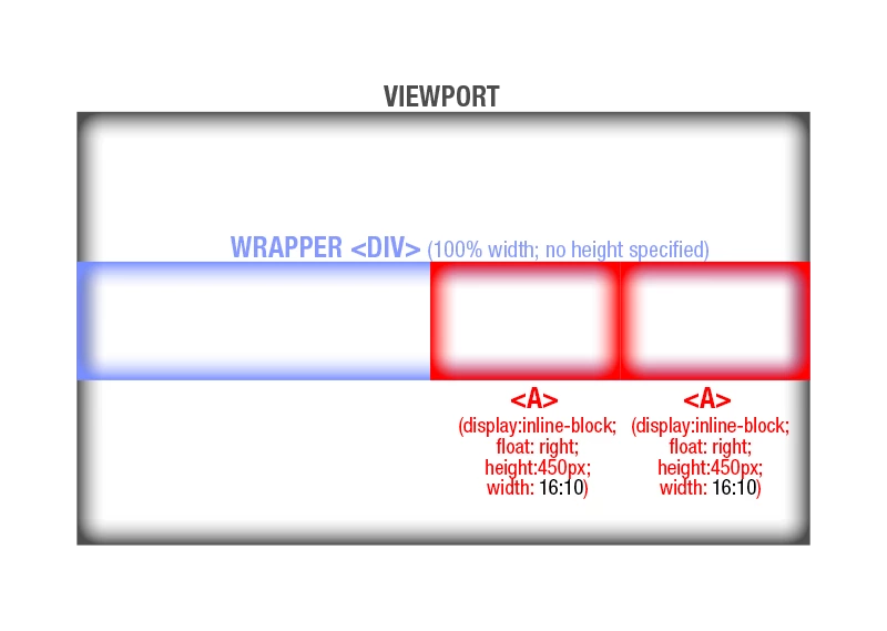

    I find visuals help, so :
    As shown, the <a>'s (child elements) will function like a row of identically-sized buttons in a nav bar, stacked against each other via float. There will be no wrapping or overflowing (the code is responsive to most size contingencies).
    I'm still very skeptical that this is even doable. Sounds more like a new feature suggestion for W3C ie, scaling by simply specifying an aspect ratio on either height or width. As a designer, the concept makes me drool.

    Under S.Author
    Dec 4, 2018 1:39 AM UTC
    I can't help but feel we're straying from the initial premise, here.
    I'll simplify the question by taking the wrapper out of it.
    Is it possible to maintain a responsive 16:10 ratio on the size of block elements (like <span> or <a>) where only one of the orientations has been specified (ie, "height:450px")?
    Here's a crude example of what I'm (clumsily) trying to ask :
    <a href="#" style="height:450px; width:???; background:url('bg.jpg') cover"></a>
    Where ??? = 16:10 aspect ratio.
    So if height changes, so does width (the way an <img>'s proportions are maintained if you set one of the sides to "auto", since it has the ratio embedded in the image itself to fall back on).
    In other words, I'm looking for a way to write : "width:160% of height" in CSS, if that's even possible.
    PS: If there's a way to do this without specifying EITHER of the sides and just letting them fill their container -- while maintaining that 16:10 ratio at all times -- even better. (Basically, fill until container height or width is reached, whichever comes first, but never losing shape, only changing scale. Like a series of identical buttons in a responsive nav bar.)
