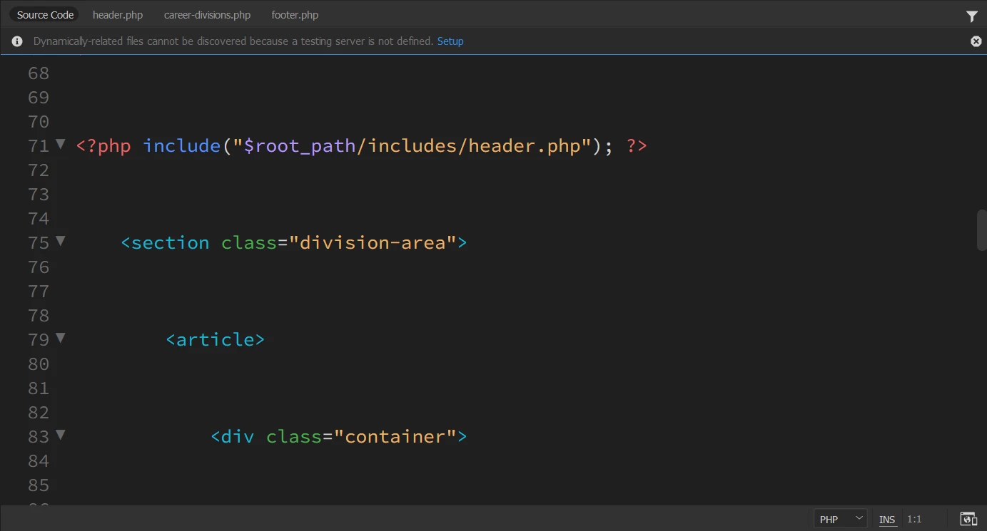

    SchmonkeeAuthor
    Mar 1, 2024 11:36 PM UTC
    Example ⬆️

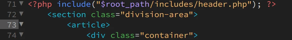

    How I want it to look:
