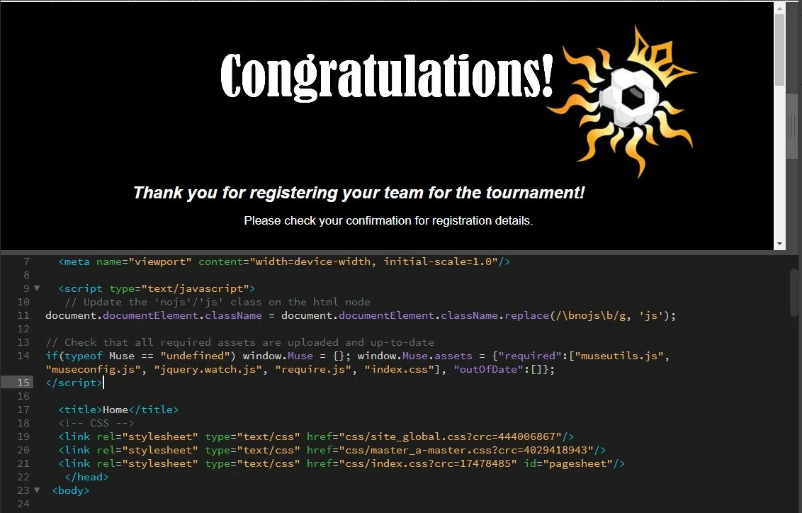

Hello, I built a MUSE webpage and exported it as an HTML page so that I could publish the page via Dreamweaver. There seems to be an issue with the coding after doing so as it does not render correctly (it is essentially a blank page). Is there an embedded MUSE code that blocks Dreamweaver from publishing the page to our hosting agency (Godaddy)? Is there a way to fix this so I am able to publish this correctly without recreating this webpage in Dreamweaver? Thank you.
