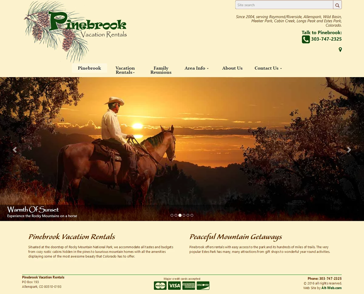

    If contact information is important, place it in the header which has greater semantic importance than the footer.
    Example made with Bootstrap:
