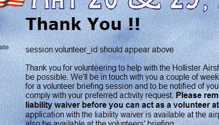

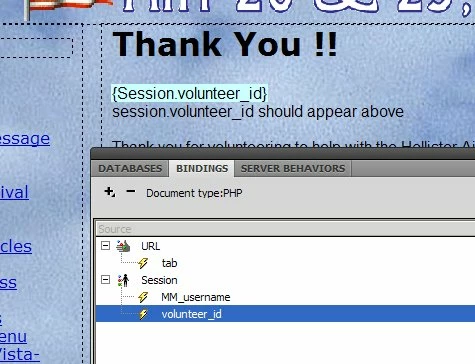

Before I create a recordset using this key I thought I'd check the session variable was set correctly so I added the session variable to the bindings panel in the success page and tried to display it by dragging the session variable onto the success page using DW CS4 as shown below.
and the code generated for this is shown below
<p><?php echo $_SESSION['volunteer_id']; ?></p>
I was expecting to see a two digit number displayed and nothing appears as shown below
- could there be a formatting issue here or have I made some other error?
To use a session variable, page needs to begin with session_start();.
