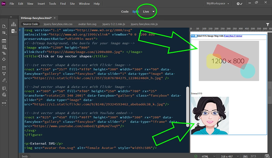

    Switch to Live View from your Document Toolbar.  As shown in my screenshot below, I can see BOTH embedded and external SVGs from Live View.  However, Design View is a holdover from the old Macromedia days and predates SVG capability.
    Hope that helps.
    Dec 2, 2021 12:30 AM UTC
    Thanks. You are exactly right. I can see the .svg in Live view.
    And I can switch from .jpg to .svg in Design view Properties tab before uploading, sort of tricking Dreamweaver.
