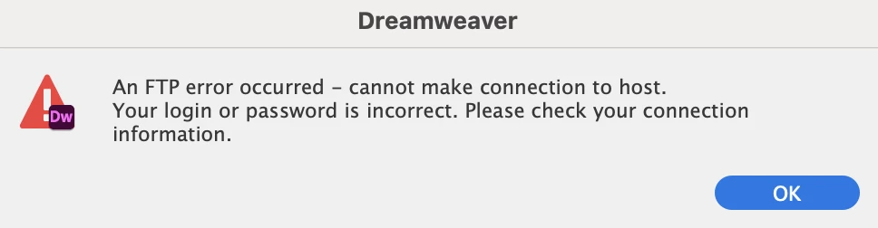

ElizabethGailLittle
Jan 7, 2021 10:24 PM UTC
Yes, I'm keeping them in separate directories.  What I have is:
websitefolder  and
websitefolder/subdomainfolder
I'm trying to set up a site in Dreamweaver with subdomainfolder as the root.  I have set up the subdomain on the server and set up an ftp account.  However, I absolutely cannot get a connection.  I worked with someone from my hosting service for an hour.  Tried lots and lots of things, but could never get a connect.  Cannot connect with username & password.  I assume some of my settings are wrong, but what!!??
My site server definition:
site name: support-remote
Connect using: ftp
ftp address: same as in working site
Port: 21
Username: editor
Password: as set up for working site/support
root directory: public_html/support
Web url: https://www.support.workingsite.com
Test result:
