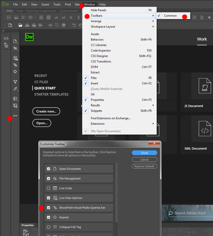

Jon Fritz
Jon FritzCorrect answer
Nov 15, 2017 3:41 PM UTC
Go to Window > Toolbars and make sure Common is checked
Click the 3 dot icon on the bottom of the vertically aligned Common toolbar
Place a check next to Show/Hide Visual Media Query Bar
Click Done
From there on out, the Show/Hide VMQ Bar icon will be in the Common toolbar....

adamwcareington
Nov 15, 2017 3:47 PM UTC
Thank you! My problem was I have my toolbar dragged onto a second monitor so I didn't see the 3 dot icon, I was looking at the top near the file name, etc.
