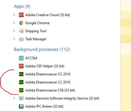

    I have the same issue, Dreamweaver won't launch.
    The process is running, and it adds more than one process if we launch more Dreamweaver.exe :
    But nothing happen.
    The only method I found is to add Dreamweaver to startup programs.
    Restart computer and Dreamweaver starts.
    Works for me.

    Dreamweaver CC 2018 just won't launch.  In Task Manager, there is a background process for each time I try to launch Dreamweaver.  I also have CS6, and THAT will not launch now either.
