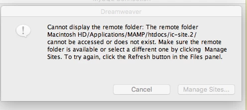

Site is not connecting to databases on localhost. Can't create or edit record sets/ DW4
I'm trying to update a book publishing site and get undefined error messages when I try to create or edit record sets.  I can see the databases in MAMP in localhost, but can't access them. I'm using DW4 and MAMP Pro. Here's the dialogue box regarding accessability:

    Checked everything.  All seems well, but still can't access. Mamp is v.4.  The site is several years old.  Just can;t access.  I'm feeling really stupid.
    Which version of PHP does Mamp use?  If it's PHP7, you're never going to connect.
    You will need PHP 5.4 or lower to use the deprecated server behavior panels.
    The panels were removed from DW in 2013 for a reason. They generate obsolete code.

    Do you actually get a response if you type localhost/site_folder_name/page_name.html into your browers url bar like below?
    localhost/ic-site.2/
    localhost/ic-site.2/index.html
    Also can you tell us what 'port' numbers Mamp is set to?
    When you start MAMP, I presume you have done that, go to Preferences and choose 'Ports'
    The information should be as follows:
    Apache Port: 80
    Nginx Port: 80
    MySQL Port: 3306
    Set MAMP ports to default
    Set Web & MySQL ports to 80 & 3306

    I assume you have set up the local site definition details correctly in DW and there is a site folder in the mamp folder with the correct name.
    Also check what php version mamp is using as the DW server behaviours were discontinued as a result of them not being compatible with newer versions of php.
    Have you ever been able to access the folder or is this the first time of trying.
    Also have you tried changing the folder name, maybe it doesnt like the . before the 2
    Have you got any other projects in the mamp folder that you can successfully connect to.
    Are the connection details -  server name, username and password to your database correct.
    The above are the kinds of things ld be checking to try and identify where the issue might lie.
