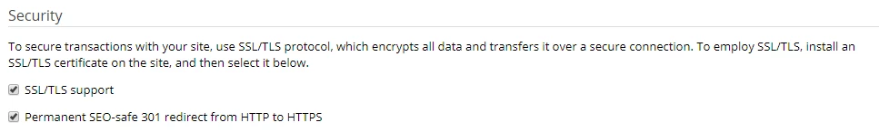

It may be an idea to find out what type of server that you are dealing with. The other two replies assume that you are hosting your site on an Apache server, but if it happens to be a Windows server, you will need to make the changes in web.config. If the server is an NGINX box, the changes will have to be made in the Plesk Panel as per
