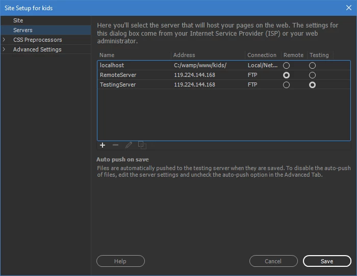

Make the Testing and Remote servers the same.

Thanks for your reply. I knew copying  the live server and use it as test server did the trick, but to me this seems a workaroud that should not be needed. I hope the guys at Adobe will make it possible to just define only a test server and make the css upload possible on that.

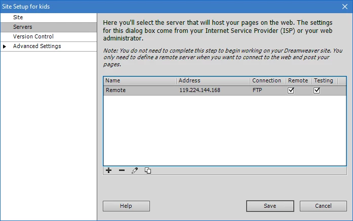

BenPleysier
Jul 31, 2017 7:13 AM UTC
In versions up to and including CS6, there was just the one liner. The current versions require two lines.
The following is CS6
