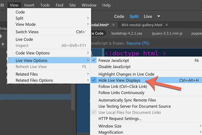

First  go to View > Live View Options > Hide Live View Displays.  Then you can Freeze JS.  Hit F6 key to resume JS.  See screenshot.

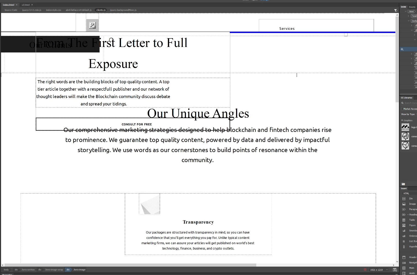

also for some reason design mode is broken beyond recognition so no way to work with it
maybe you shed some light on why this is happening?

Design View is a holdover from the Macromedia days  when everyone built sites with tables.  At best, Design View is an approximation of what you'll see in some older browsers.  I use it for quick editing.  Live View is more accurate at rendering but it's slower to work with.
The DW team implied a few years ago that they would eventually phase out Design View and improve Live View editing.  We're still waiting.   In the meantime, we have both.
