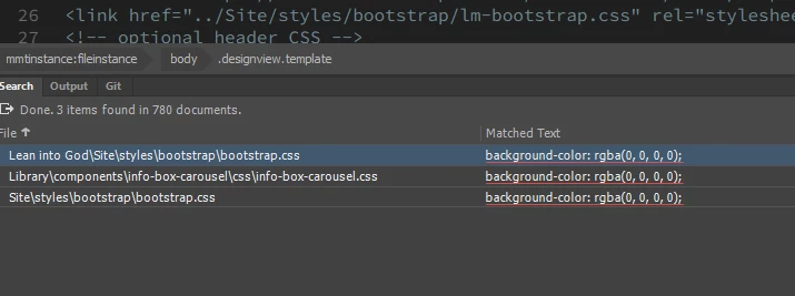

    Thank you for your quick reply. I did not find background-color: rgba(0, 0, 0, 0); in my primary css so I hit ctrl-s-f to search my entire site to get the right page. Looks like I have 3 options???

    DO NOT EDIT BOOTSTRAP!
