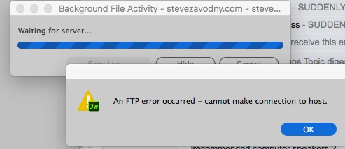

SUDDENLY first time ever cannot "PUT" or even access
I have never had to do this and cannot even upload to my site now
cuz nothing happens in response except error.  Now what?
Thanks anyone !

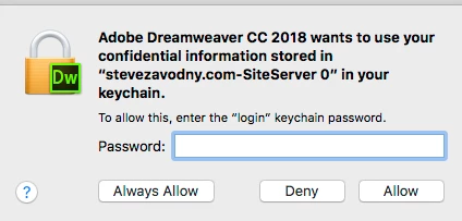

    According to the release notes from Adobe, CC 18.2 only fixes some SFTP upload issues. Apparently, using a .pem file versus a .ppk file for your private key file in the Identity File field for your server info should now work.
    The specific issue you started this thread about, the Keychain access pop-up, was not fixed in the CC 18.2 update, per Kratika's post and link.
