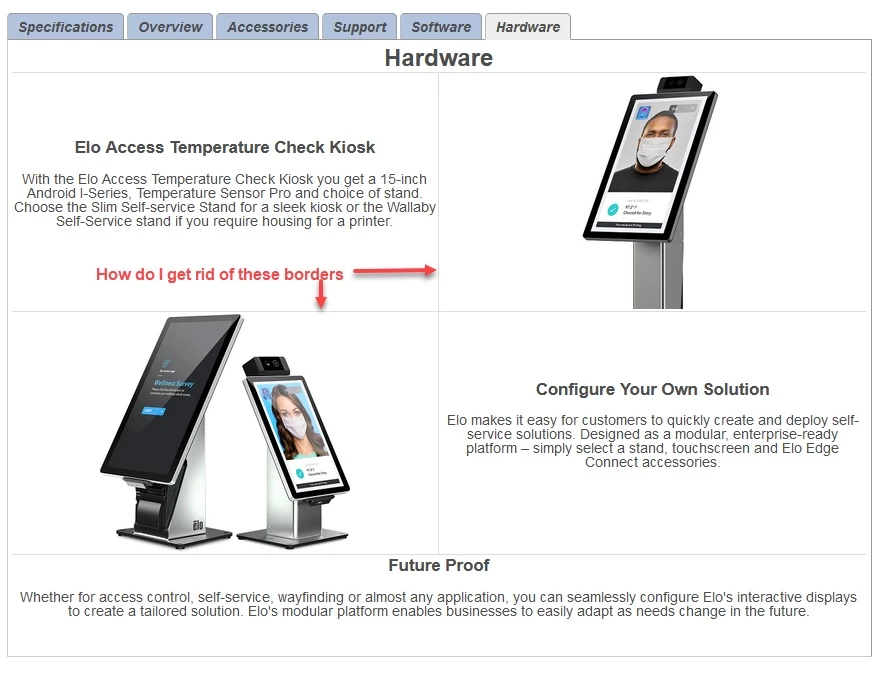

Tables in Tabs have borders I don't want
We have Dreamweaver  CS5.5 and got it to be able to use tabs on some of our WWW page and it all works fine.  Originally installed on Windows 7 (2011 time frame) but I am running Windows 10 now and Dreamweaver is not even installed since I can do what I need to do on the WWW site with what is out there already.
I have some pages with tabbed displays and when I put a table in the tab it doesn't have table borders around the table but the cells in te tabel have borders and I wish the cells did not have borders.
If I put a table on the page that is NOT in a Dreamweaver tab there will be no borders so the problem is only with tables that are in a tab.
I'm not proficent in CSS but can follow directions on how to make changes if enough details are provided for a novice like me.
To see the issue visit this URL and choose the Hardware tab to see a simple table showing borders in the cells that I would like to get rid of
https://www.touchwindow.com/c/EloTemperatureCheckBundle.html
Thanks for the ideas.

    Dec 10, 2020 2:25 PM UTC
    Look in your pages linked file below:
    themes/levels/css/all.php
    For the below css selectors and comment /*  */ the border attributes out, as shown in red.
    table.con {
    /*border:1px solid #ddd;*/
    .TabbedPanelsContentGroup table tr,
    .con tr {
    /*border-bottom:1px solid #ddd;*/
    .TabbedPanelsContentGroup table tr:last-of-type,
    .con tr:last-of-type {
    /*border-bottom:1px solid transparent;*/
    .TabbedPanelsContentGroup table td,
    .con td {
    /*border-right:1px solid #ddd;*/
    .TabbedPanelsContentGroup table td:last-of-type,
    .con td:last-of-type {
    /*border-right:1px solid transparent;*/
    Edited.
    If you DO want a horizontal line beltween the table 'sections' then DONT comment out the border on the below selector:
    .con tr {
    Plus you could add some vertical cell padding and space the text out a bit vertically by add padding and line-height on the selector below:
    .con td {
    padding: 10px 0;
    line-height: 20px;
    Dec 10, 2020 2:57 PM UTC
    On second thoughts having just looked at:
    its one of those minified bloated garbage css frameworks which should be burnt in hell - you'll find it a pain to find anything in it and work with it, unless you unminify it first. You're probably best off linking a dedicated css file to your page, which will overide the css in the 'themes/level/css/al.php' file. It must be linked to the page BELOW the 'themes/level/css/al.php' file:
    table.con {
    border: none!important;
    .con tr {
    .con td {
    padding: 10px 0;
    line-height: 20px;
    Now excuse me while I reach for the sick-bag. Frameworks have this adverse effect on me.
