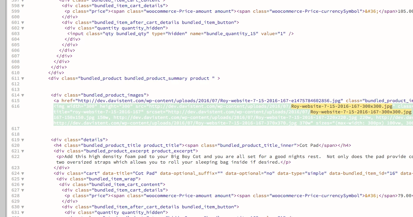

When editing and your cursor is in a tag - there is a funky "pea green" color for the background and white text - this is extremely difficult to read and I need it changed, but I am unable to find where to do that?

    Nancy OShea
    Jan 13, 2017 6:11 PM UTC
    Code color choices are very subjective.  One person's trash is another person's treasure.
    I can't understand what's so difficult about adding a CSS class to your custom LESS file?  Honestly, this is a piece of cake for anyone who works with CSS code.
    /* Custom code colors or overrides should start after this line */
    .CodeMirror-matchingtag {
        background-color: navy;
        color: white !important;
    If you can't edit CSS code, then DW is not the right tool for you.

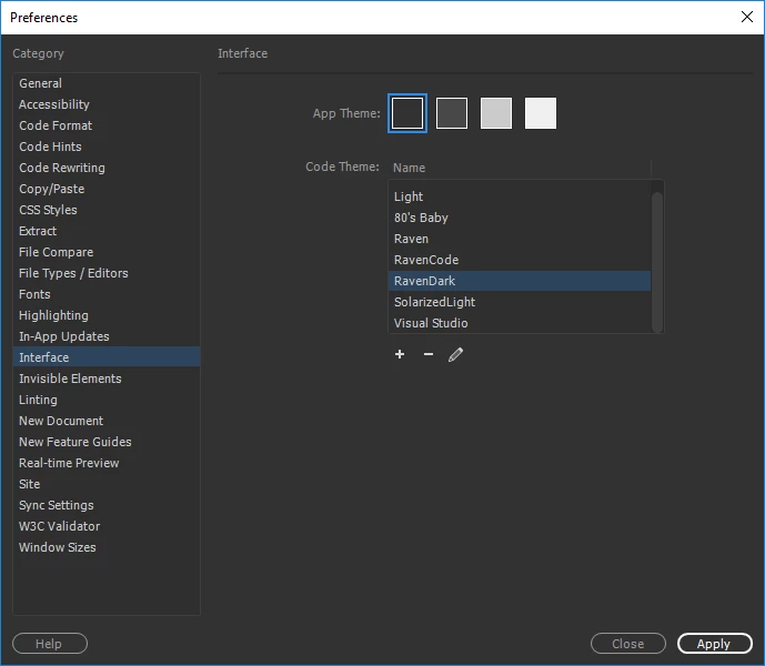

    Jon Fritz
    Jan 12, 2017 4:15 PM UTC
    Here's how you fix it...
    1. Go to Edit > Preferences > Interface
    2. Click Light
    3. Hit the + button under the Theme box
    4. Give your modified theme a name
    5. Click Create
    6. Make sure your new theme is highlighted
    7. Hit Apply
    8. Now with the new one highlighted, hit the pencil icon
    9. Scroll down to the .CodeMirror-focused .CodeMirror-selected selector
    10. Change the background to a setting you like, something like #EBE7B3 (muted yellow) works
    11. Save
    12. highlight something and see if you like it, if so, you're done, if not, play around until you do
    Jon Fritz
    Jan 12, 2017 4:27 PM UTC
    Woops, that selector is for the text-selection highlight color, you actually have to add a selector to the base theme to change the color of selected tags (when you single click the tag and it highlights).
    Add this to the end of your new theme file...
    .CodeMirror-matchingbracket, .CodeMirror-matchingtag {
        background-color:#EBE7B3;
