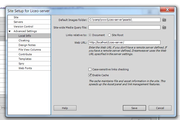

    May 27, 2017 6:43 PM UTC
    The site folder I've been working on in called Liceo-tester and it' located in My Web Sites. My testing folder is located in Wamp/www and it's called Liceo-server.
    When I try to assign Liceo-server to be the testing server for Liceo-tester, it still doesn't work...
    In your example, your local folder and your testing server are the same, if I'm correct. I tried that too, that is making my site folder and testing folder the same wamp/www/Licep-server and it still doesn't work.
    I'm sure I followed all of the instructions you gave me to configure the server. Thanks all of you for helping!!!

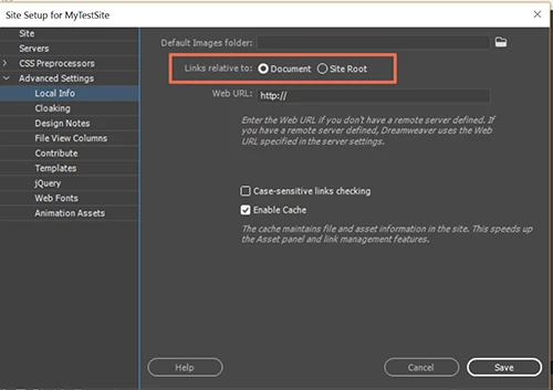

    Nancy OShea
    May 25, 2017 10:09 PM UTC
    Are you using site root relative links?  When working locally, site root relative links will drill all the way down to your computer's hard drive which causes a failed response.  However, it works just fine on a remote server.
    I prefer to use document relative links when working locally.  See screenshot.
