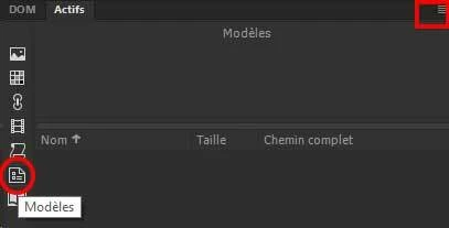

    4. In Dreamweaver, open the Assets panel, select the Templates tab, then use the small panel menu and choose Recreate Site List.
    5. If the templates appear again, try creating the new page from File > New > Site Templates.
    6. If they still do not appear, close and reopen Dreamweaver, then check the site definition again.
