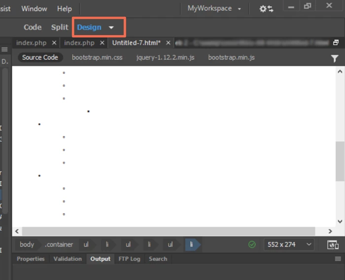

Switch to Design View not Live View and you won't have problems working with lists.

Why not save some time & use built-in Emmet code shortcuts to create your lists?
Type the code below followed by Tab key.
ul>li*5>ul>li*4
Results in this.

Then switch to Design View & edit as needed.

That's not my experience in Design View.  Live view is another matter.  I rarely use it except to check my layout once in a while.
For editing I typically use Split with Code & Design.   Also check your error indicator to ensure you have a green checkmark at all times.  A red X denotes code errors which can cause DW to do strange things.
