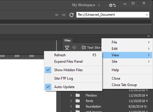

If your Hidden Files are turned on at the OS level, you may just need to turn them on in DW 2021's Files Window.
1. Go to Window > Files (or hit F8) if the Files Window is not open
2. Click the small menu icon in the upper right of the Files Window
3. Click View
4. Verify a check is next to Show Hidden Files

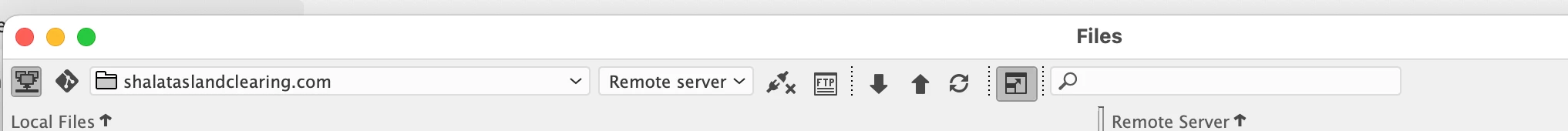

Click the small menu icon in the upper right of the Files Window...
this is the part I can't find. On the left top is a small icon that when moused over says show files. I can't see any other icon that has a drop down to show hidden files.

Jon FritzCommunity ExpertCorrect answer
Dec 30, 2020 1:46 PM UTC
3. Click View
