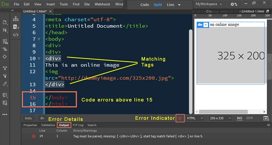

    Nancy OShea
    Feb 7, 2017 5:40 PM UTC
    See screenshot.  Hopefully this will help you identify code errors while you work.  In the example below, I have 2 un-closed <div> tags from line 9 and line 8.
