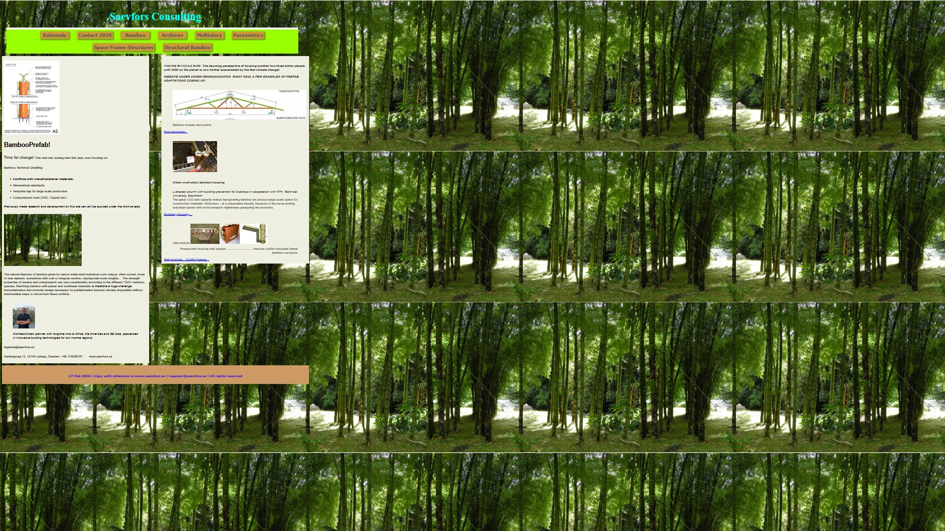

Unexpected enlargement when launched
When everything finally was organized with your help here, and the code launched many times on the web for various check-ups:
All of a sudden, the web browser version is enlarged out of proportion, distorted and the text no longer nicely wrapped as in DW! What could be the problem now? The FTP service recently updated?
As I wrote earlier, the nightmare is not over…

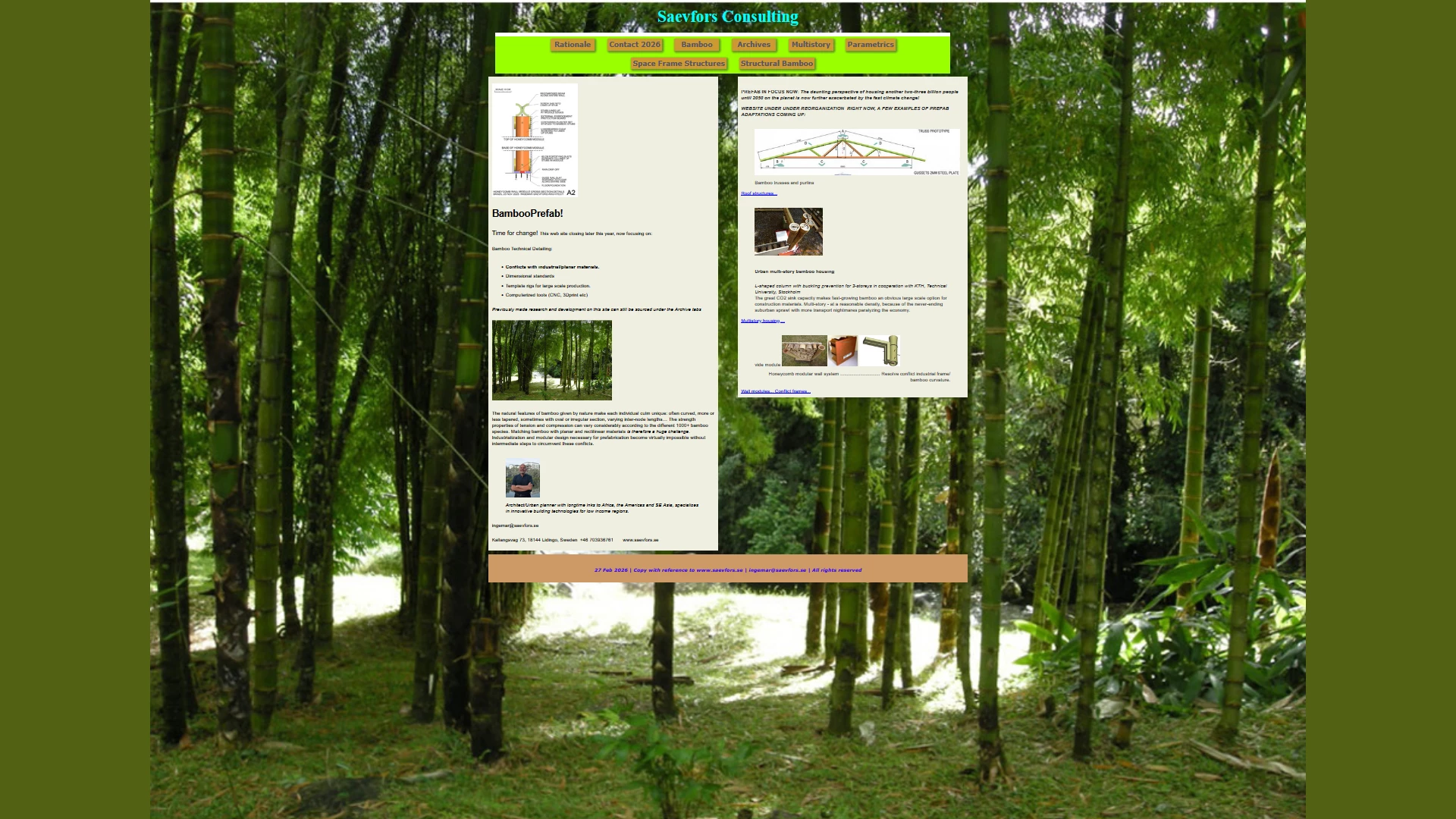

    ingo9Author
    Mar 3, 2026 3:19 PM UTC
    Thank you Nancy! Gemini works very well and all remaining issues have now been solved. So,
    you can close this thread now. Ingemar

    Your background image repeats on large devices which doesn’t look professional.
    For a more polished appearance, use CSS background-size:cover and no-repeat. This will scale your background-image more appropriately.

    Feb 28, 2026 8:48 AM UTC
    Nancy, Feb 28
    Thanks for very useful tips re background!
    And the link to W3-Validation because when I tried it myself:
    I gave up tracking the reason and used your link to W3 which works fine.:

    This website code looks now perfect in DW Live view. When launched on the internet all the text wrapping is gone! I know you all in Adobe Forum say that Floats are obsolete but, they are still used in the <figure> and Flex values?  The text wrapping is nice for saving screen space and makes reading more appealing. The system with rows and columns results in a lot of wasted space and img size distortions. Or, is it a requirement for accommodating different screen sizes?
    I also saw on your screen dump that you get the same “no wrapping of text” effect as me. So, no need to worry about my Chrome browser cache.
    If you could detect what’s wrong with my code, I would be extremely grateful. /Ingemar

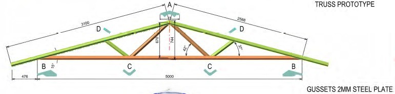

    Nancy OShea
    Feb 25, 2026 10:11 PM UTC
    This is invalid code.
    width: max 1200px;
    Change it to this:
    max-width: 1200px;
    You’ll also need other adjustments. This image is far too wide to fit the container.
    https://www.saevfors.se/images/Truss_protot.jpg
    .right_side img {max-width: 100%;}
    Hope that helps.

    ingo9Author
    Feb 26, 2026 8:25 AM UTC
    26 Feb Nancy
    It did help regarding the sizing; But not for the wrapping of text, which was perfect just before, with the recent method <figure> <figcaption> etc. Now:
    https://www.saevfors.se/web_26_contact.html
    I copy the code again in case some new mistakes can be detected. It seems as if an important character is missing?
    Thanks, Ingemar
