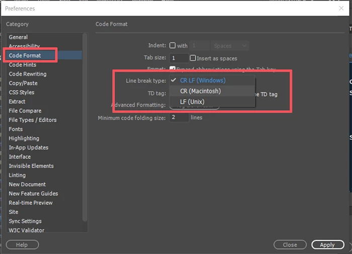

Windows and Macs use different Line Breaks.    CR LF = Win, CR or LF =  Mac/Unix.
Using a Windows PC and a Mac to transfer same files up & down from server can introduce conflicts in the line beaks which might explain the script errors.

Hello Nany OShea,
thank you very much for your quick very helpful answer.
Switching the preferences in DW running on a MAC to "CR LF (Windows)"-Format fixes the problem.
Is this logical? Never mind - it works!
I the meantime I made serveral changes to my form-handler.php and the form runs even after uploading it on the server.
Because the problem belongs to the Server I use - it might be interesting for other users - my webside is running with a Linux server.
So using Mac, Linefeed as "CR LF (Windows)", as descibed by Nancy, with a Linux server seems to be the right combination.
