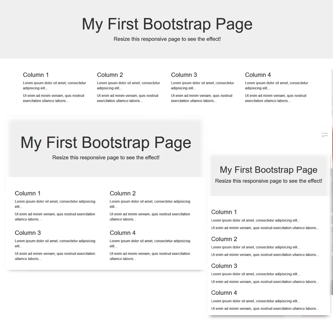

As Birnou correctly said, the HTML structure in Bootstrap is very different from legacy Fluid Grid Layouts.   The old FGLayout code is not compatible with Bootstrap and vice versa.
Bootstrap uses a 12-box grid system inside a container and row.   In this example, 4 columns on desktops breaks to 2 columns on smaller devices and 1 column stacked vertically on mobile phones.  This is achieved through column classes for xs, sm, md & lg devices.
<!DOCTYPE html>
<html lang="en">
<head>
<title>Bootstrap Example</title>
<meta charset="utf-8">
<meta name="viewport" content="width=device-width, initial-scale=1">
<link rel="stylesheet" href="https://maxcdn.bootstrapcdn.com/bootstrap/3.3.7/css/bootstrap.min.css">
<script src="https://ajax.googleapis.com/ajax/libs/jquery/3.3.1/jquery.min.js"></script>
<script src="https://maxcdn.bootstrapcdn.com/bootstrap/3.3.7/js/bootstrap.min.js"></script>
</head>
<body>
<div class="jumbotron text-center">
<h1>My First Bootstrap Page</h1>
<p>Resize this responsive page to see the effect!</p>
</div>
<div class="container">
<div class="row">
<div class="col-sm-6 col-lg-3">
<h3>Column 1</h3>
<p>Lorem ipsum dolor sit amet, consectetur adipisicing elit...</p>
<p>Ut enim ad minim veniam, quis nostrud exercitation ullamco laboris...</p>
</div>
<h3>Column 2</h3>
</div>
<h3>Column 3</h3>
</div>
<h3>Column 4</h3>
</div>
</div>
</div>
</body>
</html>

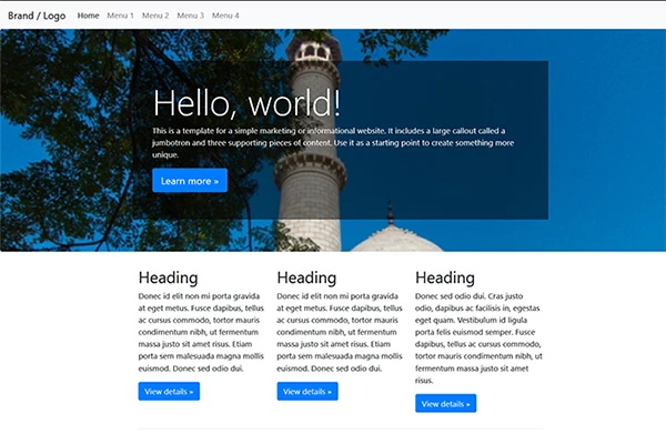

First of all, this is NOT Bootstrap.   It's legacy Fluid Grid Layouts which I don't recommend using.   2 totally different frameworks with vastly different features --  Bootstrap being the better one.  I also don't understand why a course would make any mention of FGLayouts in a 2018 syllabus.   This is an old feature that should be allowed to die.
Below is a basic Bootstrap 4 layout.
You can copy & paste the code below into a new, blank document and play with it in DW 2018.
<!doctype html>
<html lang="en">
<head>
<title>Bootstrap 4 Starter Page</title>
<meta http-equiv="X-UA-Compatible" content="IE=edge">
<!--Bootstrap 4 CSS-->
<link href="https://maxcdn.bootstrapcdn.com/bootstrap/4.0.0-beta/css/bootstrap.min.css" rel="stylesheet" integrity="sha384-/Y6pD6FV/Vv2HJnA6t+vslU6fwYXjCFtcEpHbNJ0lyAFsXTsjBbfaDjzALeQsN6M" crossorigin="anonymous">
<style>
body {padding-top: 3.5rem}
/**placeholder image**/
.jumbotron {background: url(https://placeimg.com/1200/500/arch) no-repeat center center fixed;
background-size:cover;
.jumbotron > .container {background: rgba(0,0,0,0.5); padding: 3%; color:#FFF}
</style>
</head>
<body>
<nav class="navbar navbar-light navbar-expand-md bg-light justify-content-center fixed-top"> <a class="navbar-brand" href="#">Brand / Logo </a>
<button class="navbar-toggler" type="button" data-toggle="collapse" data-target="#navbarsExampleDefault" aria-controls="navbarsExampleDefault" aria-expanded="false" aria-label="Toggle navigation">
<span class="navbar-toggler-icon"></span>
</button>
<div class="collapse navbar-collapse" id="navbarsExampleDefault">
<ul class="navbar-nav mr-auto">
<li class="nav-item active"> <a class="nav-link" href="#">Home <span class="sr-only">(current)</span></a> </li>
<li class="nav-item"><a class="nav-link" href="#">Menu 1</a></li>
<li class="nav-item"><a class="nav-link" href="#">Menu 2</a></li>
<li class="nav-item"><a class="nav-link" href="#">Menu 3</a></li>
<li class="nav-item"><a class="nav-link" href="#">Menu 4</a></li>
</ul>
</div>
</nav>
<main role="main">
<!-- Main jumbotron for a primary marketing message or call to action -->
<div class="jumbotron">
<h1 class="display-3">Hello, world!</h1>
<p>This is a template for a simple marketing or informational website. It includes a large callout called a jumbotron and three supporting pieces of content. Use it as a starting point to create something more unique.</p>
<p><a class="btn btn-primary btn-lg" href="#" role="button">Learn more &raquo;</a></p>
</div>
</div>
<!-- Example row of columns -->
<div class="row">
<div class="col-md-4">
<h2>Heading</h2>
<p>Donec id elit non mi porta gravida at eget metus. Fusce dapibus, tellus ac cursus commodo, tortor mauris condimentum nibh, ut fermentum massa justo sit amet risus. Etiam porta sem malesuada magna mollis euismod. Donec sed odio dui. </p>
<p><a class="btn btn-primary" href="#" role="button">View details &raquo;</a></p>
</div>
<h2>Heading</h2>
</div>
<h2>Heading</h2>
<p>Donec sed odio dui. Cras justo odio, dapibus ac facilisis in, egestas eget quam. Vestibulum id ligula porta felis euismod semper. Fusce dapibus, tellus ac cursus commodo, tortor mauris condimentum nibh, ut fermentum massa justo sit amet risus.</p>
</div>
</div>
<hr>
</div>
<!-- /container -->
</main>
<footer class="container">
<p>&copy; Company 2017-2018</p>
</footer>
<!-- Bootstrap core JavaScript
Placed at the end of the document so tpages load faster -->
<!--latest jQuery Core-->
<script src="https://code.jquery.com/jquery-3.2.1.min.js" integrity="sha256-hwg4gsxgFZhOsEEamdOYGBf13FyQuiTwlAQgxVSNgt4=" crossorigin="anonymous"></script>
<!--Popper JS-->
<script src="https://cdnjs.cloudflare.com/ajax/libs/popper.js/1.11.0/umd/popper.min.js" integrity="sha384-b/U6ypiBEHpOf/4+1nzFpr53nxSS+GLCkfwBdFNTxtclqqenISfwAzpKaMNFNmj4" crossorigin="anonymous"></script>
<!--latest Bootstrap 4 JS-->
<script src="https://maxcdn.bootstrapcdn.com/bootstrap/4.0.0-beta/js/bootstrap.min.js" integrity="sha384-h0AbiXch4ZDo7tp9hKZ4TsHbi047NrKGLO3SEJAg45jXxnGIfYzk4Si90RDIqNm1" crossorigin="anonymous"></script>
</body>
</html>
