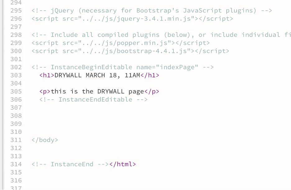

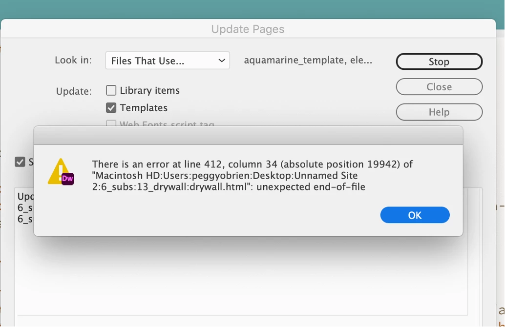

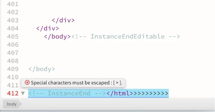

using template, getting unexpected end-of-file, it also generates many >>>>>>
below is the code it refers to...
I do not put in the extra >>>>> after the /html>
just lost.....please help Peggy

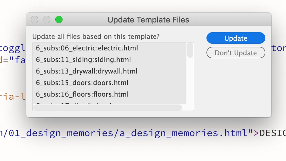

    I open the index.html,

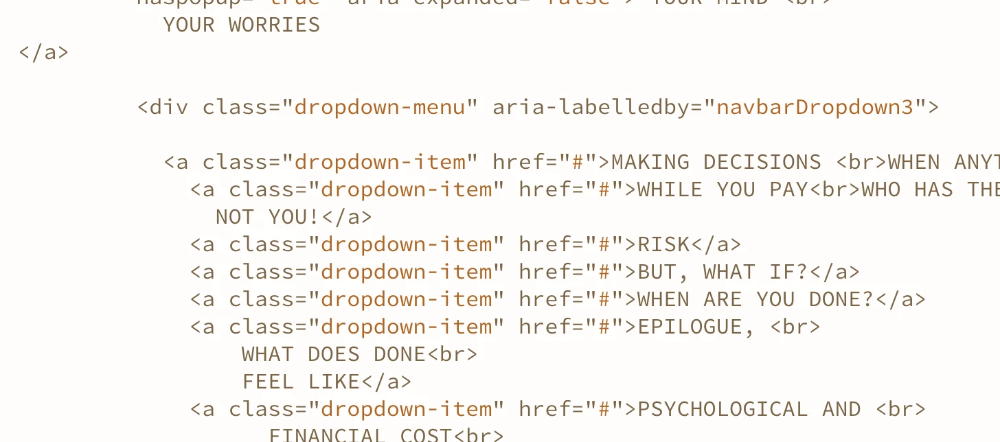

    change the # marks (see below) to new file names like drywall.html
    I use the template to manage a huge NavBar….8 across, 10 down…like 100 pages.

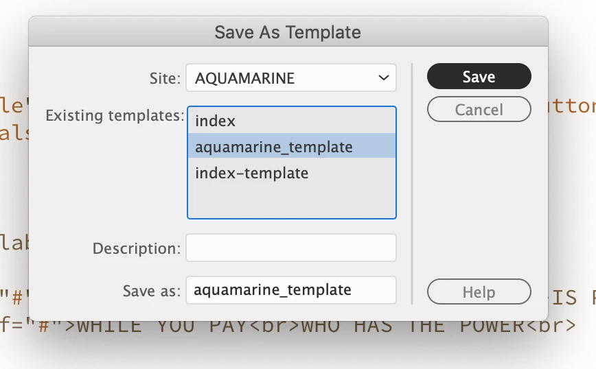

    File =>Save as Template. (in this case I save it as aquamarine_template.
    I say YES to updating links.
    Make a new file, using this template, it is called untitled.html
    I save it as drywall.html
    I save the aquamarine_template.dwt.
    see the log below...

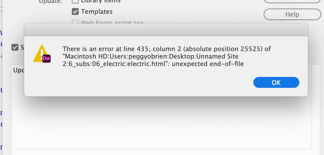

    not updated, error in template or instance file
    Updating Macintosh HD:Users:peggyobrien:Desktop:Unnamed Site 2:
    6_subs:06_electric:electric.html -- not updated, error in template or instance file
    6_subs:11_siding:siding.html -- not updated, error in template or instance fileupdated 1_design_the_dream:03_flex_house:flex_house.html

    I do a WINDOW => RESULTS=> VALIDATION , and do not come up with errors...
     the clue is the >>>> generated for some reason. near the end of the /html.  closing ?
    thanks for considering this... Peggy
