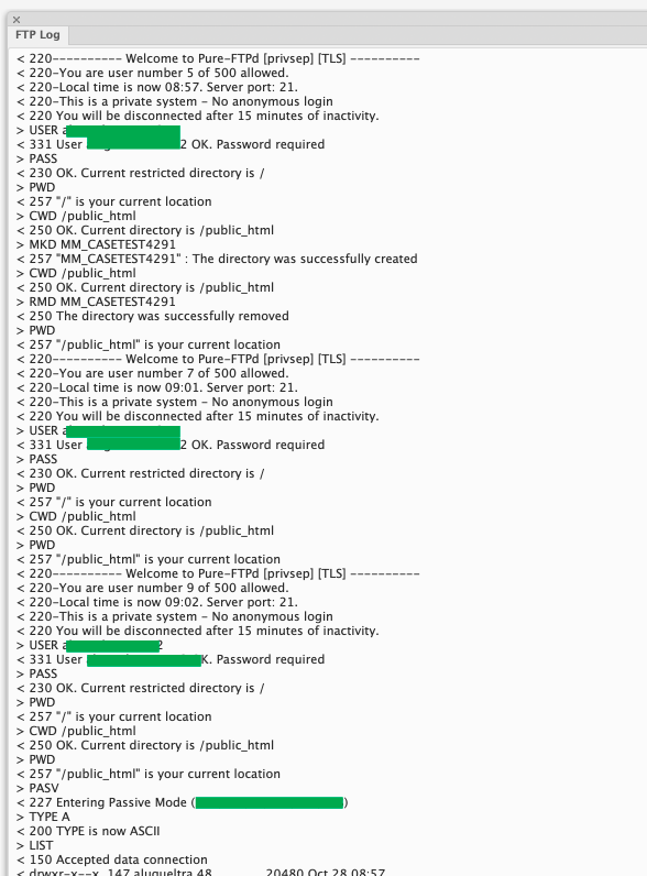

What happens if you connect with your Mac studio with Filezilla? Does it connect immediately or is it experiencing issues? If your desktop is experiencing issues with Filezilla, it may be an issue with a firewall or something that needs to be dived into further with your desktop. If your desktop is connecting fine with Filezilla regardless of your wife's computer, then the issue is DW. If that is the case you could go to Site -> Advanced -> FTP log and view the log the next time you transfer to see if any errors are generated while attempting to connect.

Attached the FTP logs.

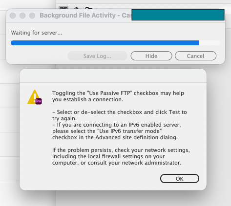

See screenshot from Manage Sites:
In this example, I'm calling the host server's IP address rather than a hostname.
Toggle settings under More Options.
Hit the TEST button to confirm if you're able to connect.
