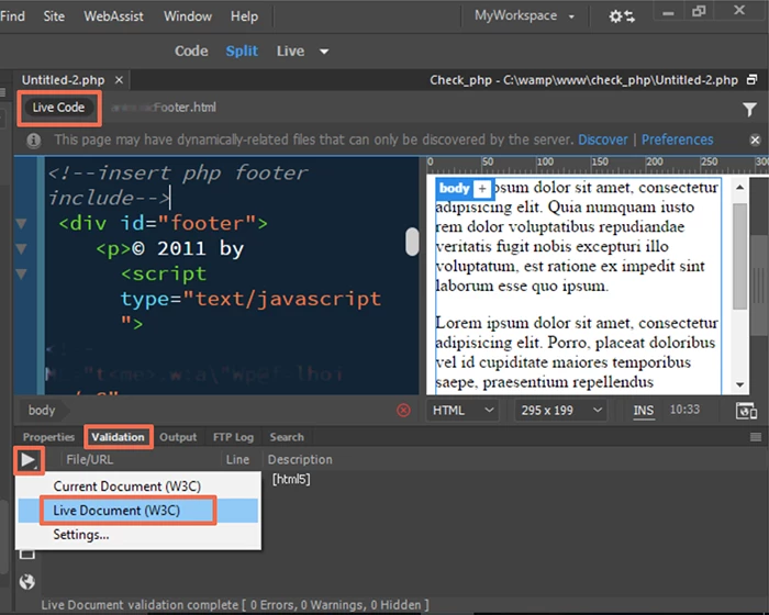

    As PZ said, W3C validation is useless on raw PHP code.  You need to check the Live Code.
    Assuming you have a local PHP development environment set-up in CC 2017,  open your PHP document.  Go to View > Live Code.  This will parse the PHP code and display the document as one would see it in a browser on the server.
    Go to Window > Results > Validation.
    Click the triangle to check Live Document.  See screenshot.
    Nancy
