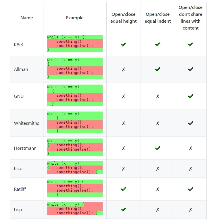

want allman code formatting on php code in dreamweaver 2019
I want allman source formating in php code, but here have only retliff formate

    I'm not arguing, but it's not question of performance there, but readability...
    when we work on dozens of projects simultaneously and in addition with teams that have different requirements (isolated closures or not, tab vs spaces, extended verticality distance...) the formatting of the code quickly becomes an unavoidable necessity...
    on the beta forum itself we have 4 different topics just on formatting

    Line #34 of the script says:
    brace_style (default "collapse") - "collapse-preserve-inline" | "collapse" | "expand" | "end-expand" | "none"
    put braces on the same line as control statements (default), or put braces on own line (Allman / ANSI style), or just put end braces on own line, or attempt to keep them where they are.
