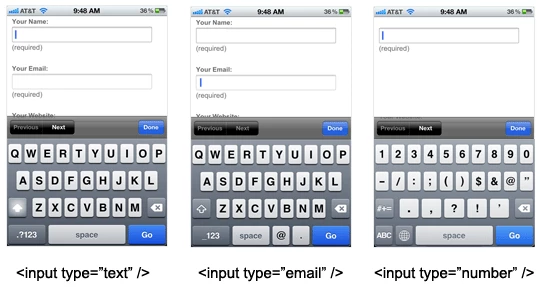

HTML5 form input types are much more than just to validate (client side) the input, they also facilitate inputs for handheld devices.
On a desktop, input type email will look like a normal text field
while on a mobile phone, the popup keyboard is optimised for the input of an email address.
For contemporary web design, the input type is not an option.
