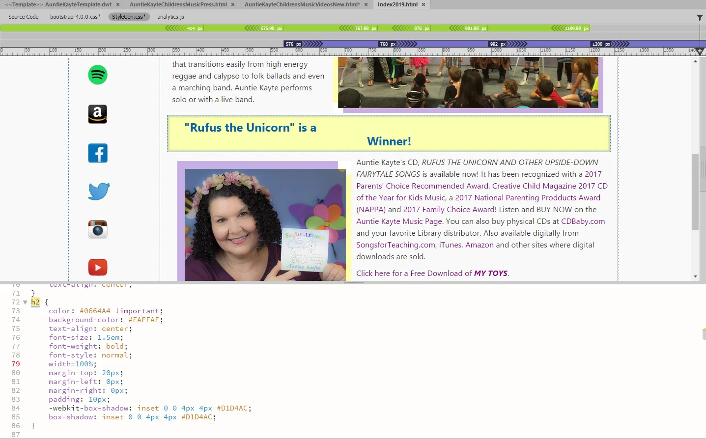

I had this page working, and then suddenly in the middle of the page, the h2 header is broken in a really weird way and is interacting strangely with the photo above. I can't find anything in the CSS or my source code to explain it.

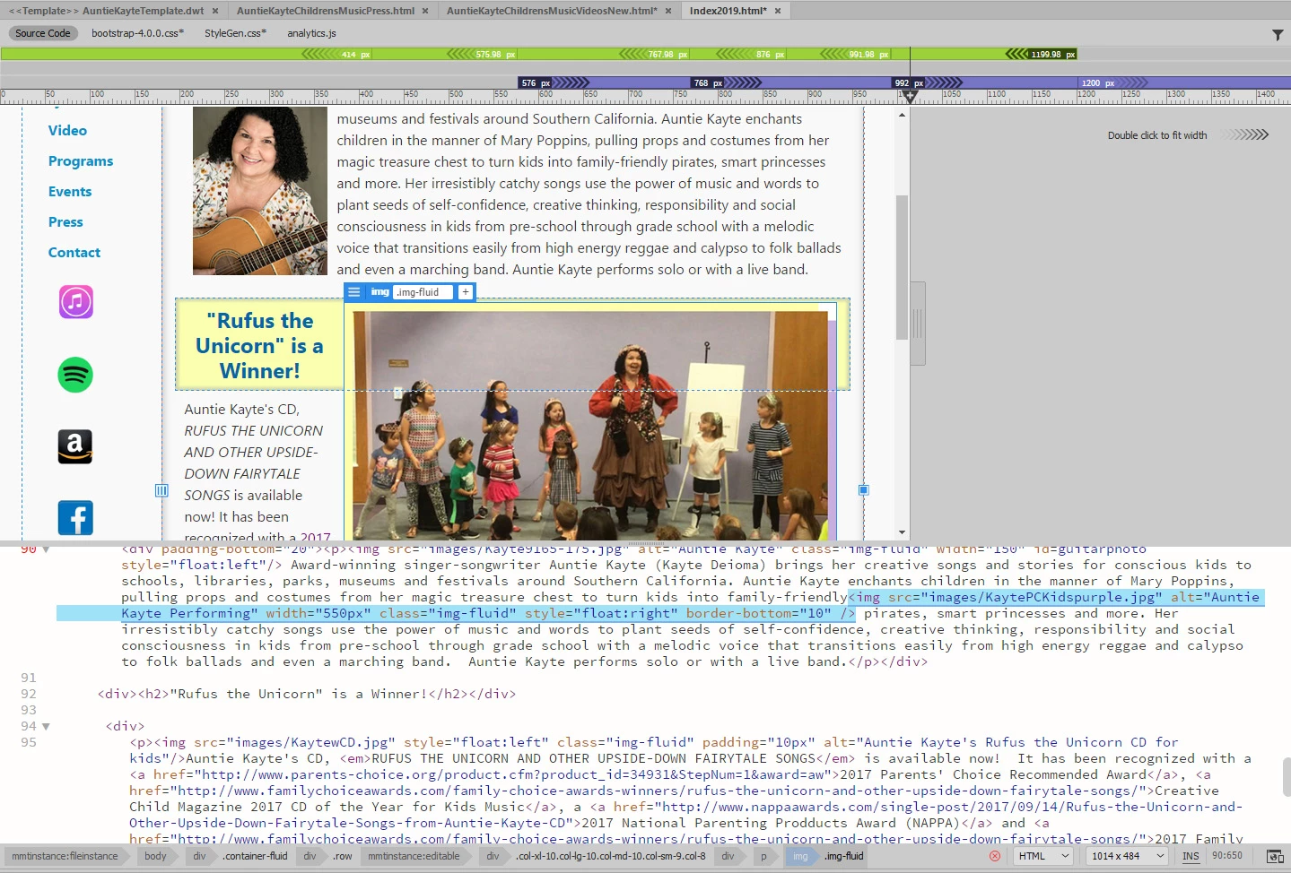

The first issue is that the title itself breaks into 2 broken lines at 1200px screenwidth and above, even though there's plenty of room for it.
From 992 to 1200px the image from the above paragraph, which is in a separate <div> and <p> section, jumps down on top of the h2 heading.
A 3rd issue is that the margin above and below the h2 header doesn't work at those wider widths either. I've searched through all the @media attributes for different screen sizes in the bootstrap CSS, but couldn't see anything obvious that would trigger this behavior.
Any ideas? Screen shots below.

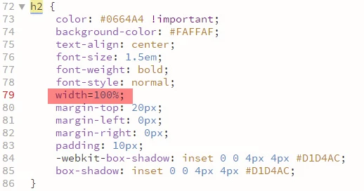

To start with, you've got a syntax error on line 79 in your CSS:
Should be width: 100%; Fix that and see what else needs addressing.
