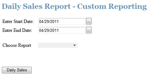

I have a simple cfm page with three Form elements: startDate, endDate, and a Spry Menu with links to my seven reports.
I have added "Parameters" for the form.startDate & form.endDate and passing them to the Reports in my Spry menu dropdown.
- Here is a sample Report URL after clicking a report in my Spry drop-down:
http://192.168.1.77/DailySalesReport/reports/01_DSR_Mgt_Report_by_Sales.cfr?startDate={ts '2011-05-06 00:00:00'}&endDate={ts '2011-05-06 00:00:00'}
- What is causing the weird Start & End Dates that have the "{ts" name & brackets?
- Why are my Dates typed in above on my Form page not being forwarded in the Report URL?
Note: In testing, If I use a normal Submit button on the page (see Daily Sales button below), to run a report, it works fine and the parameters are passed to the report and the report prints just the data for April.
- Here is the Full Code listing for the page: http://cerberus.clearwave.com/jerry/SalesHTML.txt

If I "manually" add the dates to my report URL, the report filters properly and runs..
http://192.168.1.77/DailySalesReport/reports/01_DSR_Mgt_Report_by_Sales.cfr?startDate=04/01/2011&endDate=04/30/2011
So, this seems to be an issue with my report link unable to "grab" the "form.startDate" and form.endDate" on my main page/form and "Pass" them to the report URL?
Anyone have any ideas..?
