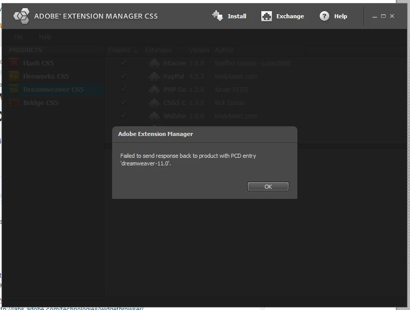

    Junaid Atari
    May 2, 2010 6:15 PM UTC
    I got this error during install this extention.
    Any solution to install this extention successfully?
    I was looking "intellisence" like now availabe in DW (PHP code intellisence).
    Randy Edmunds
    Adobe Employee
    Adobe Employee
    May 2, 2010 6:59 PM UTC
    Sorry, that's a third party extension, so I'm not sure what the problem is. I successfully installed an earlier version of that extension on a beta  version of DW CS5. Has anyone else successfully installed it in DW CS5?
    Randy
