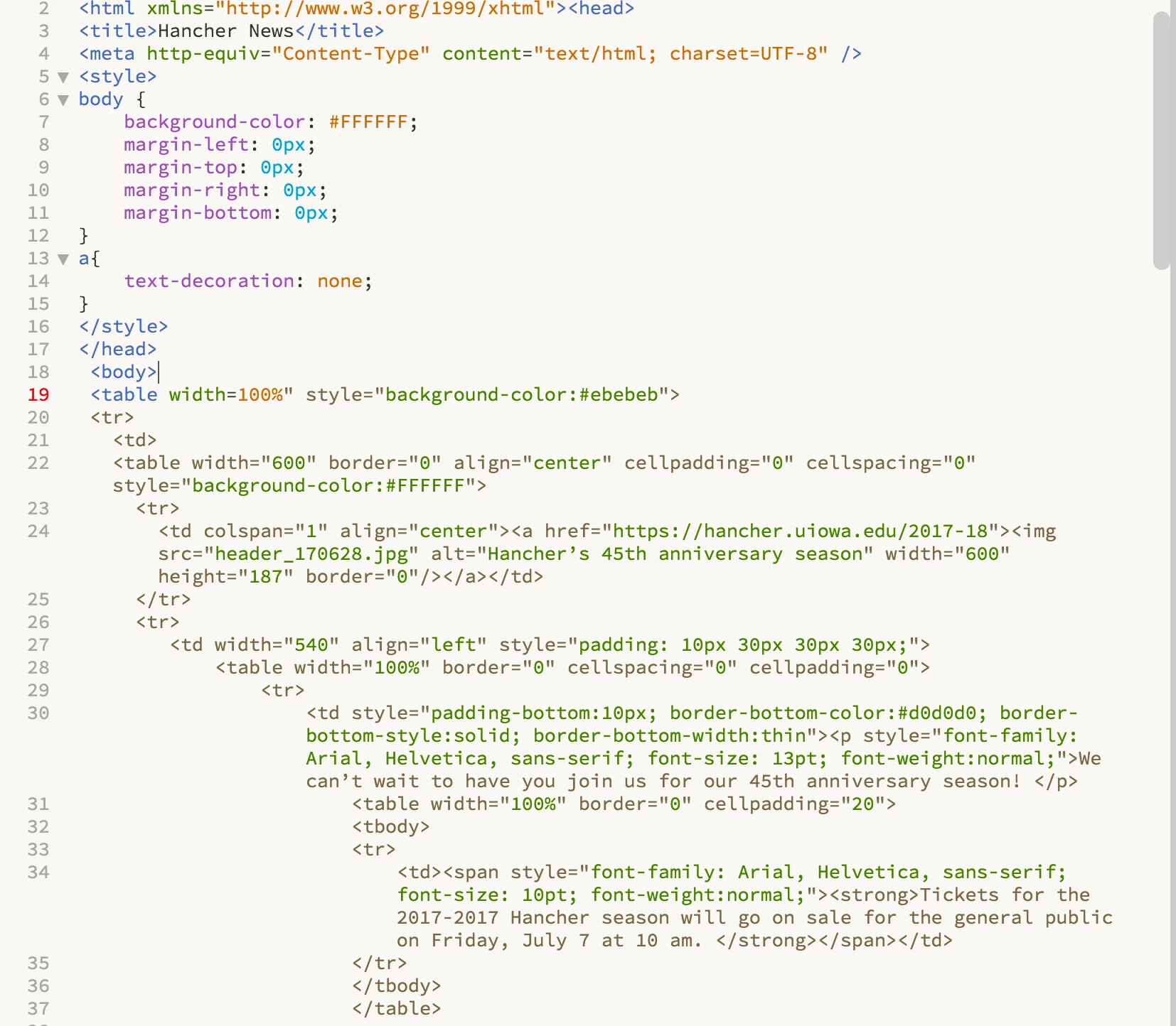

Can someone help me figure out why my code turns brown and green midway through line 19? Even when I strip away all the content to the bare minimum, it's still brown and green. Thanks!

Because of an error on line 19.
(you're missing a " around your width)
The error is also why the line number, on the left side of the code window, is highlighted in red. If you hover the red number, it will give you a tool tip hint as to what's wrong.
