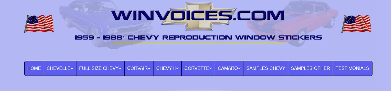

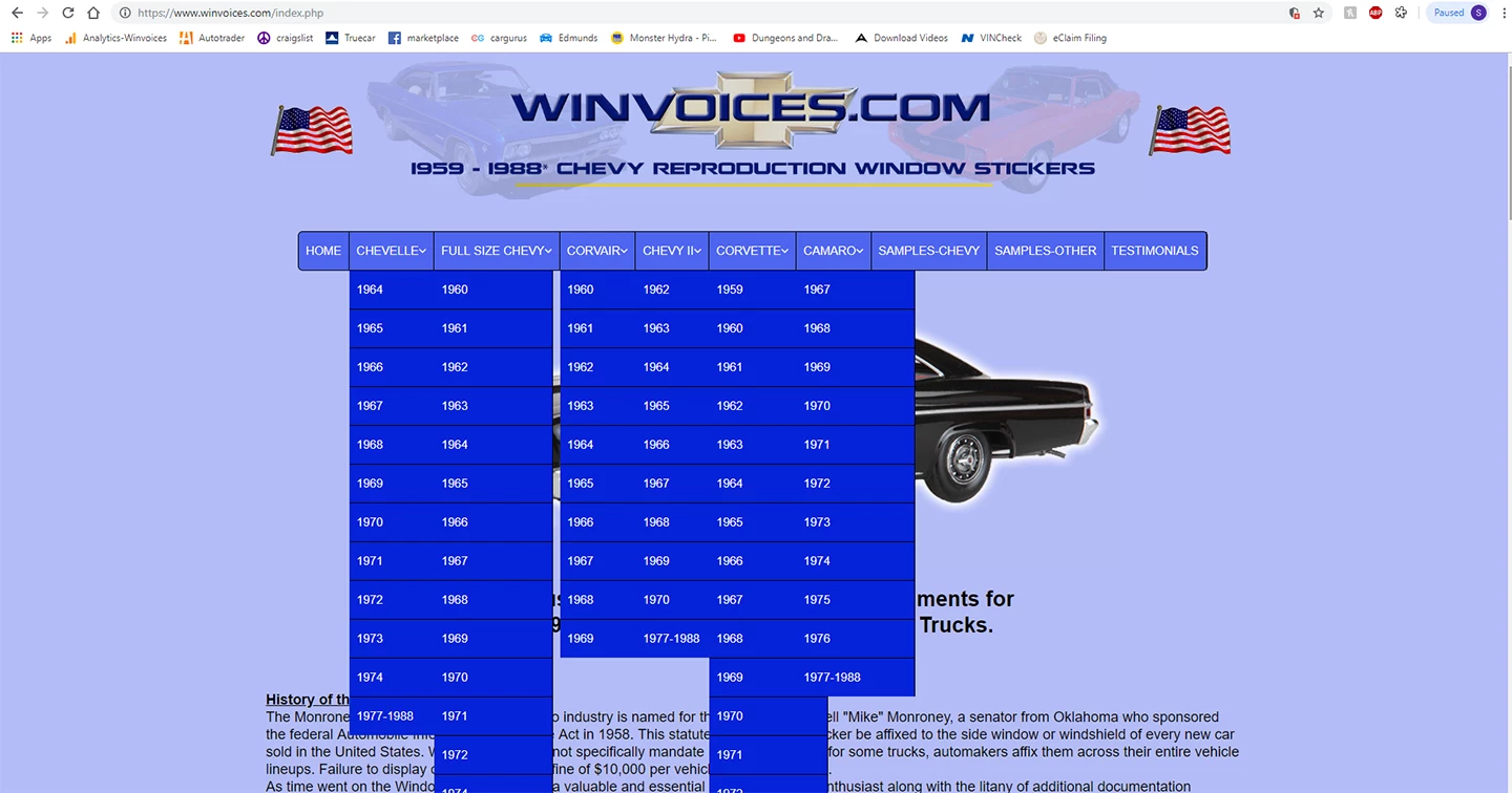

My navigation bar has always worked fine in Chrome. I added one more page to the menu and now all my submenus are visible and the links with submenus don't work. I tried it in Mozilla and it seems fine, but it always worked in Chrome.
The site is www.winvoices,com
Here is a screenshot of the problem.

This is hat I see when using Chrome:

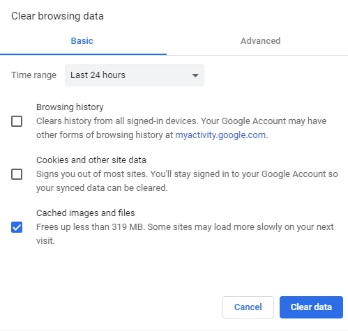

There my be a caching problem in your case. Press CTRL+SIFT+DEL and Clear data
Apr 19, 2019 1:48 AM UTC
Cleared my data and cache..no change. Tried 2 other computers, same problem.
