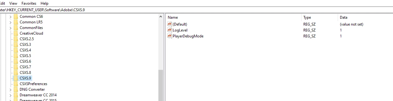

I'm just starting to create my 1st panel and I hope i did everything right.
I'm stuck on the with the alerts about unsigned extensions.
I added PlayerDebugMode 1 to all the CSXS and am still unable to run my 1st panel.
I also restarted my win10 and still the same.
running win10 with latest version of photoshop.
any clue why?

Problem solved!!!
I rechecked all my steps and found out that my reg key: PlayerDebugMode had a space at the end of it.
removing the space solved the problem.
