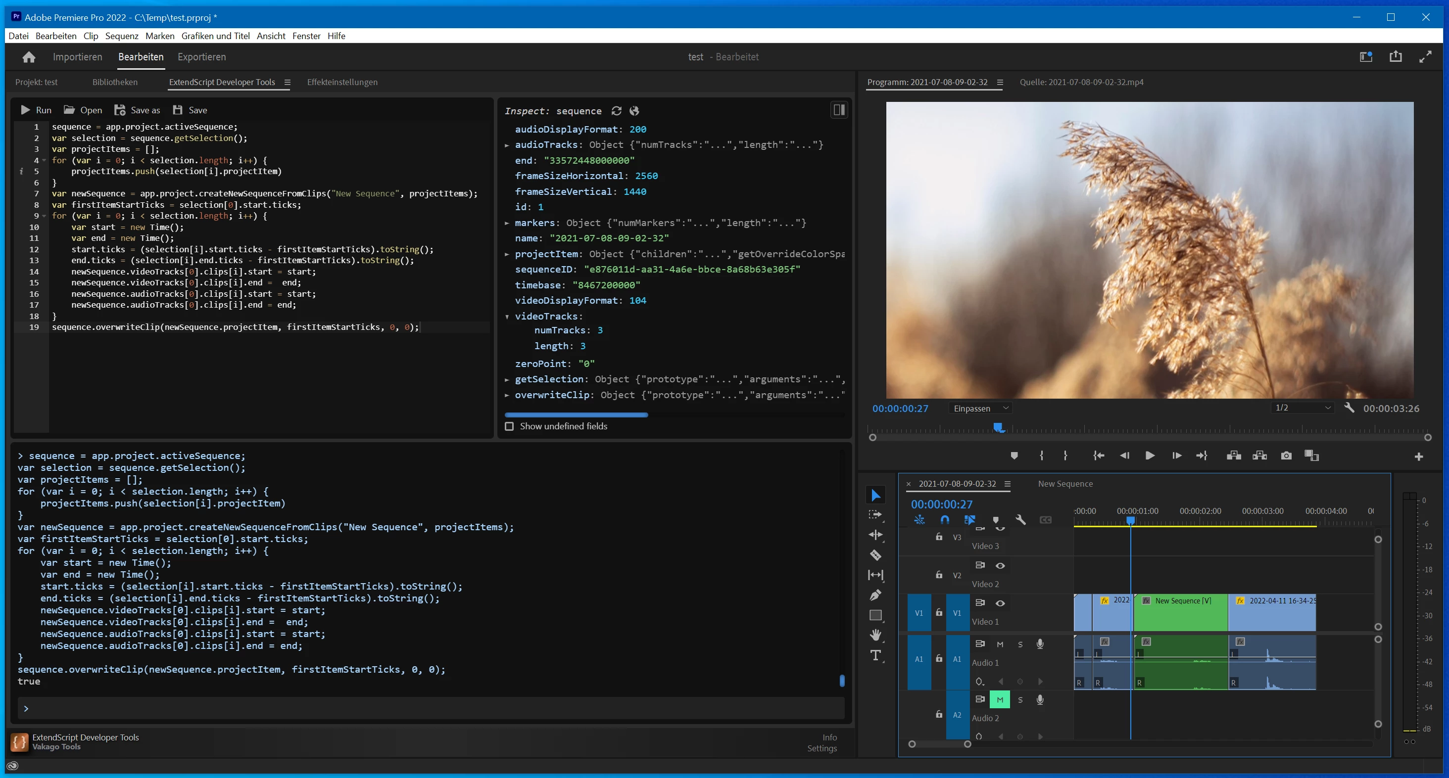

Below you can see a small proof of concept that is very similar to the "nests" functionality in Premiere Pro. It creates a new sequence and moves the selection to this sequence. The cuts (start / end) are then restored in the nested sequence.

Below you can see a screenshot where the above script is executed in the Dev Tools extension. After executing the script, a "nested" sequence is created. However, effects are lost in this very basic implementation. But copying those should also be possible. Depending on your needs this might be an alternative to the approach where you are removing unused clips from a copy of the active sequence.
