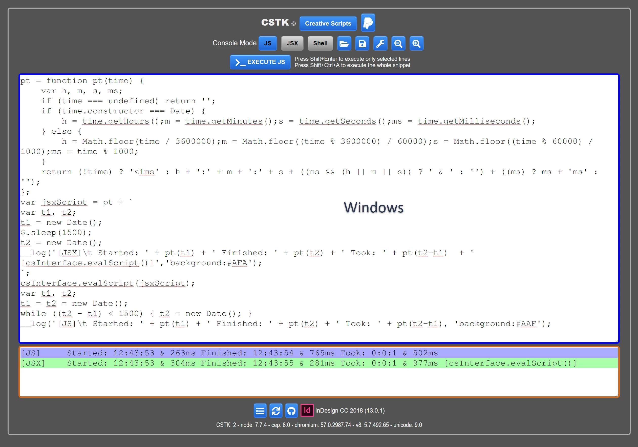

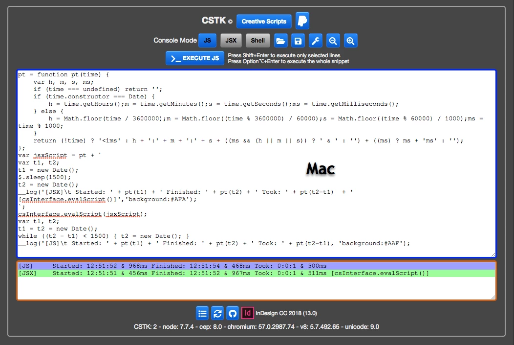

Here's a couple of screen shots
This is the code I used on the CSTK

If you look at the Windows screenshot you can see that the JS execution is not halted by the JSX execution (Asynchronously).
On the Mac you can see that the JS execution is halted by the JSX execution (Synchronously).

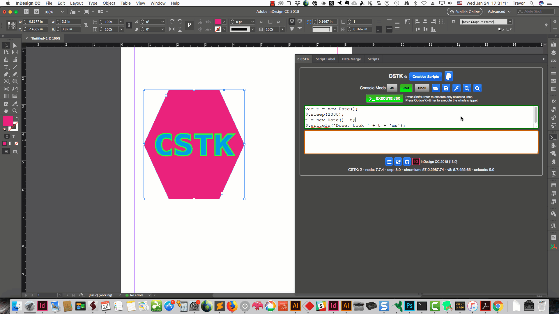

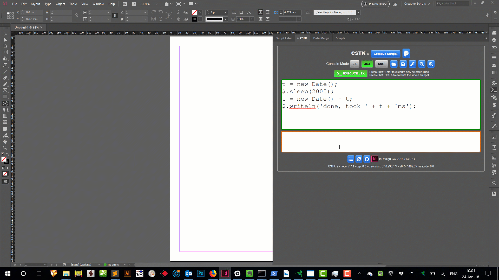

You can see this with the following 2 gifs
When one executes some code on the CSTK on executing the code the keyboard shortcut next to the execute button highlights.
After the codes been processed the bottom console changes color.
On Windows you can see the sleep time on the Mac you can't as the highlight that should happen before the sleep is blocked by the csInterface.evalScript

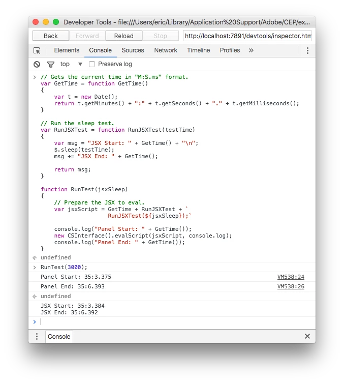

You can copy that entire block of code (comments included) and paste it into a Chrome Debugger console to evaluate. You can then run it by simply typing something like this:
RunTest(3000);
Which will cause the JSX thread to sleep for 3 seconds in between a bunch of print statements. This is simply an expansion of the testing code I provided here. In addition to a noticeable pause during execution, this version will show you timestamps of each call.
Here is an example of a run on macOS:
Note: When run from an external application (e.g. Chrome browser or cefclient), it appears that the target Adobe application needs to be the focused application (e.g. Premiere Pro) when running on macOS. Simply switch to the application to allow the code to process.
For clarity, the output (minus the "undefined") is:
Panel Start: 35:3.375
Panel End: 35:6.393
JSX Start: 35:3.384
JSX End: 35:6.392
If you reorder based on actual timing, it looks like the following:
JSX Start: 35:3.384
JSX End: 35:6.392
Panel End: 35:6.393
On macOS, the Panel doesn't get to finish its work until the JSX is done.

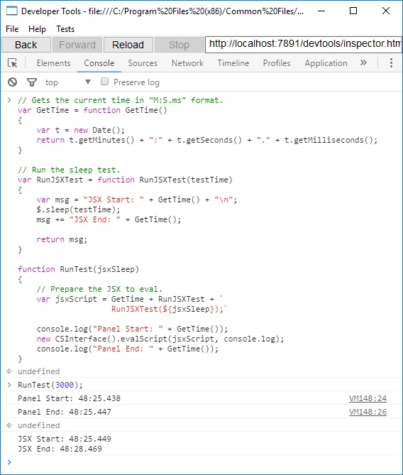

On Windows, however, the image is rather different:
For readability, the output is:
Panel Start: 44:10.111
Panel End: 44:10.119
JSX Start: 44:10.199
JSX End: 44:13.233
No reordering is necessary whatsoever. The times are already in order. This is the expected output. On Windows, the Panel appears to send a request to run the JSX, rather than starting up the ExtendScript engine and waiting for it to complete.
Now if you try this out on InDesign you can access the CSTK target engine. You can hard code it or use the ESTK for that.
Then you can run the JS while loop (make it a bit longer to make testing easier) on the CSTK
pt = function pt(time) {
    var h, m, s, ms;
    if (time === undefined) return '';
    if (time.constructor === Date) {
        h = time.getHours();m = time.getMinutes();s = time.getSeconds();ms = time.getMilliseconds();
    } else {
        h = Math.floor(time / 3600000);m = Math.floor((time % 3600000) / 60000);s = Math.floor((time % 60000) / 1000);ms = time % 1000;
    return (!time) ? '<1ms' : h + ':' + m + ':' + s + ((ms && (h || m || s)) ? ' & ' : '') + ((ms) ? ms + 'ms' : '');
var t1, t2;
t1 = t2 = new Date();
while ((t2 - t1) < 8500) { t2 = new Date(); }
__log('[JS]\t Started: ' + pt(t1) + ' Finished: ' + pt(t2) + ' Took: ' + pt(t2-t1), 'background:#AAF');
