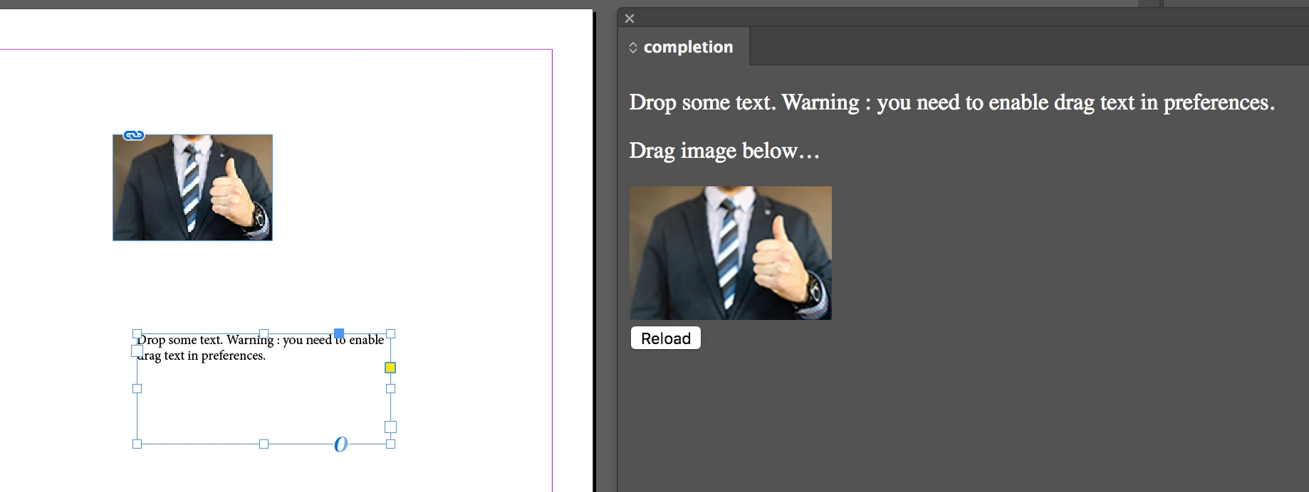

I created a HTML5 addon/extension for Adobe Indesign by using extension builder 3. For drag and drop image and text from extension to Indesign document. But when drag and drop images on the document, it shows path of image not the image itself. Also not able to drop the text.

Loic.Aigon
May 9, 2018 12:58 PM UTC
Here is how you can process:
<?xml version="1.0"?>
<!DOCTYPE html PUBLIC "-//W3C//DTD XHTML 1.0 Transitional//EN" "http://www.w3.org/TR/xhtml1/DTD/xhtml1-transitional.dtd">
<html
  xmlns="http://www.w3.org/1999/xhtml">
  <head>
   <meta charset="utf-8">
    <script src="../js/libs/jquery-1.9.1.min.js"></script>
    <script src="../js/libs/CSInterface.js"></script>
    <script src="../js/libs/AgoraLib.js"></script>
    <script src="../js/libs/Vulcan.js"></script>
    <script src="../js/libs/extendscript.js"></script>
    <script src="../js/libs/theme.js"></script>
     <link rel="stylesheet" href="../css/styles.css">
    <script>
       var csInterface = new CSInterface();
    function drag(ev) {
        var eid = String(ev.target.id);
        csInterface.evalScript ( "checkContext()", function(result) {
            if(result=="true") {
                if(eid=="p"){
                    var filePath ="monTexte.txt";
                    window.cep.fs.writeFile(filePath, document.getElementById(ev.target.id).textContent);
                    csInterface.evalScript("loadPlaceGun('"+filePath+"')")
                else{
                    var filePath = decodeURI(String(ev.target.src).replace(/^file:\/\//, "") );
      </script>
  </head>
  <body>
  <p id="p" draggable="true" ondragstart="drag(event)">Drop some text. Warning : you need to enable drag text in preferences.</p>
  <p>Drag image below…</p>
  <img id="i" src="../assets/drop.jpg" draggable="true" ondragstart="drag(event)"/>
  <br/>
  <button onclick="window.location.reload()">Reload</button>
  </body>
</html>
and in extendscript (main.jsx)
function checkContext(){
return String(app.documents.length>0);
function loadPlaceGun(filePath){
    var file = File(filePath);
    if ( !file.exists) return;
    app.toolBoxTools.currentTool = UITools.PLACE_CURSOR_TOOL;
    app.activeDocument.placeGuns.loadPlaceGun(file);
FWIW
Loic
