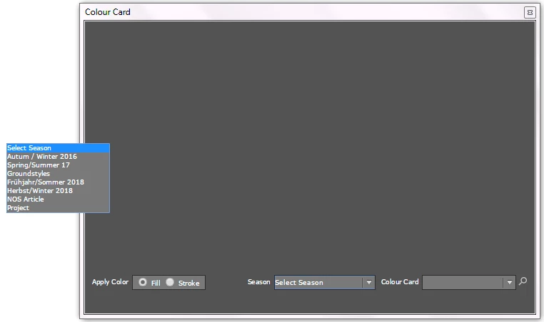

drop down values loads out of extension window for 1st time alone
        I have an issue with drop down values being loaded out of the extension window for the first time (i.e.) when extension window is not focused.

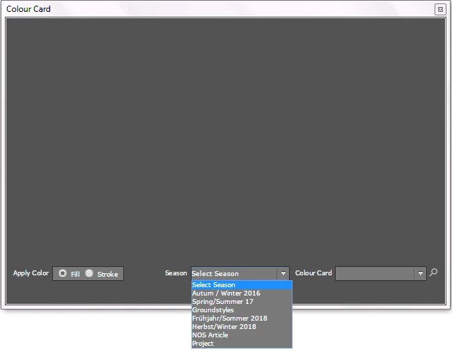

But from the second time, it loads correctly.
Can anybody tell me how to resolve this. Will focusing on Extension window solve this problem? If so please guide me how to focus on extension window. Thank you.

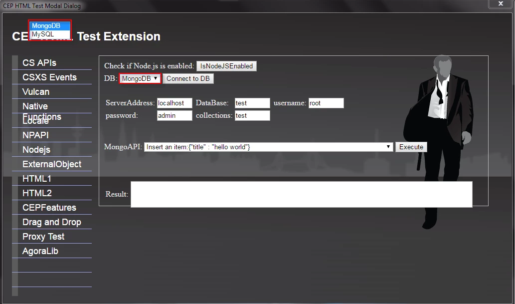

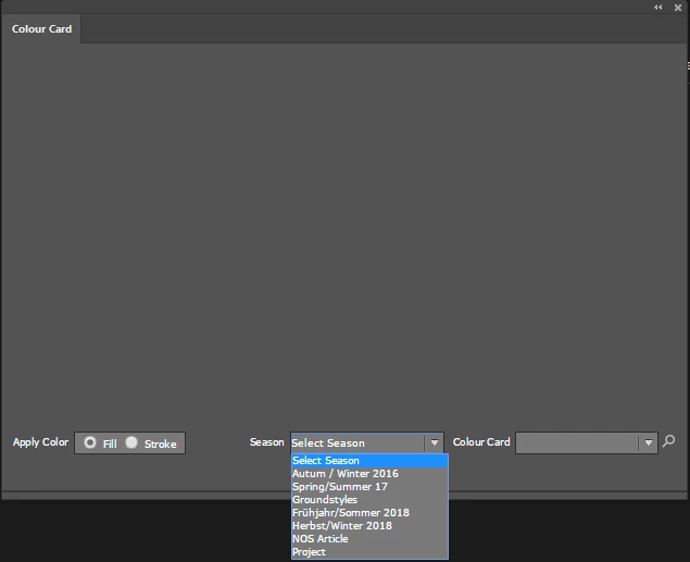

Update : I'm getting this issue if CEP extension UI type is a Modal or Modeless dialog. I'm not getting this issue if UI type is Panel
I checked even with sample from gifthub. I'm getting the same issue
Can anybody tell me how to resolve this. Thank you.
