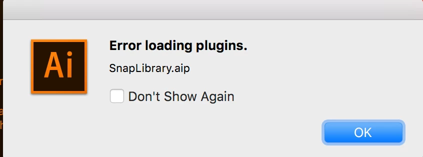

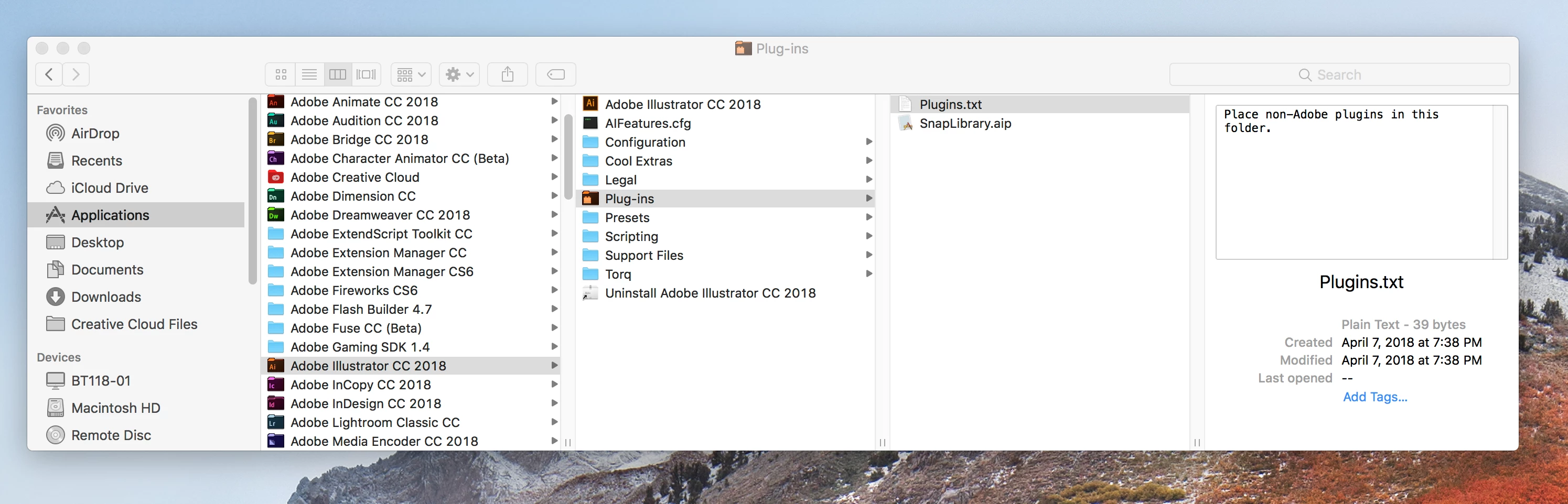

SnapFashun
Nov 20, 2018 8:10 PM UTC
I'm hoping someone can help with this.......there's a plugin (snapfashun.aip) that worked perfectly on MAC for every past version of IllustratorCC and when IllustratorCC 2018 came out the plugin no longer shows up in the window drop down even though it shows up in the plugins folder (see attached photo). Does anyone know why this is happening or what's changes since CC2017.....and most importantly how to fix it?
erinferinferinf
Adobe Employee
Adobe Employee
Nov 27, 2018 8:03 PM UTC
Hi SnapFashun,
I can verify that SnapLibrary.aip works correctly in Illustrator 2017 but does not appear in 2018 or 2019, instead I get this error when Illustrator launches:
This is all on Mac OS 10.13.6 High Sierra.
Are you the plugin's developer or a regular user? If you're a user, I'd contact the developer. If you're the developer, I can try to get someone on the Illustrator team to help.
SnapFashun
Nov 28, 2018 5:44 PM UTC
Thank you for the reply. We are the developer however we are not able to figure out what happened with the combo of Illustrator 2018 and High Sierra........it works with High Sierra and Illustrator 2017 and all previous editions. There are no issues with Windows in any Illustrator Version. Any assistance or contact with Adobe will be helpful. So far any attempts to reach out to Adobe ends up in the forum discussions only. Thank you.

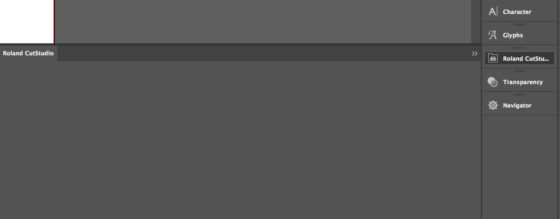

Oct 24, 2017 8:21 AM UTC
I´m sorry to say that these changes did not fix the problem on my end:
  1. changing Host version in maifest.xml to <Host Name="ILST" Version="[19.0,22.0]"/>
  2. com.adobe.CSXS.8 PlayerDebugMode 1
All extension panels still show up, but the content is missing. And not only the panels I'm working on myself, but also panels I installed, like the Getty Image extension.
So, I looked into the log files (in folder: /Users/[myname]/Library/Logs/CSXS) of my sample panel and compared these files:
  1. CEPHtmlEngine7-ILST-21.1.0-com.adobe.Samples.Panel.log
  2. CEPHtmlEngine8-ILST-22.0.0-com.adobe.Samples.Panel.log
The first log file showed all items that had been loaded with the old Ai version, but the second has a sign problem:
2017-10-23 16:29:42:772 : INFO  CEPHTMLENGINE, begin to verify the signature of "com.adobe.Samples.Panel"
2017-10-23 16:29:42:772 : INFO  CEPHTMLENGINE, end to verify the signature of "com.adobe.Samples.Panel", isSigned false, isAdobeExtension false
2017-10-23 16:29:42:772 : ERROR Signature verification failed for "com.adobe.Samples.Panel"!
The Getty Image extension log file has a lot of Errors as well:
[1024/092909.037613:ERROR:child_thread_impl.cc(762)] Request for unknown Channel-associated interface: ui::mojom::GpuMain
extension id:(none)
My colleges are using my packed extension I created for Ai 21 in Ai 22 and they work fine. So, it seems to be a problem with my development environment.
Any ideas on this?

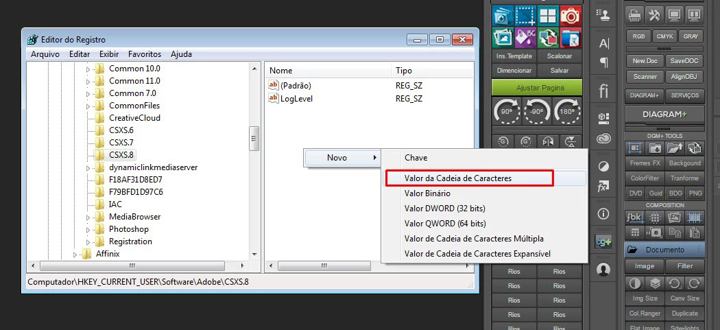

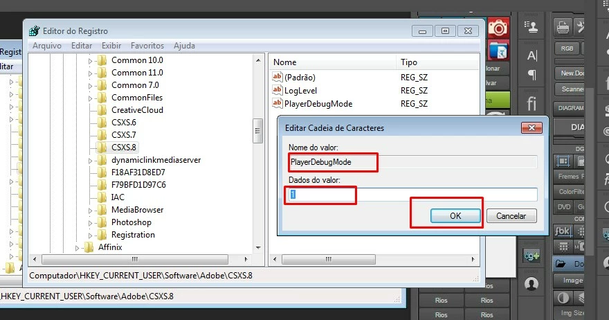

mauricior6328708
Oct 20, 2017 10:28 PM UTC
I also did the same problem and was able to resolve by editing the CSXS preference properties file, located at:
Win: regedit> HKEY_CURRENT_USER / Software / Adobe / CSXS.8, add a new PlayerDebugMode entry of type "string" with a value of "1".
Mac: At the terminal, type: write patterns com.adobe.CSXS.8 PlayerDebugMode 1 (The plist is also located in /Users/USERNAME/Library/Preferences/com.adobe.CSXS.8.plist)

anneliesb49420484
Oct 19, 2017 11:52 AM UTC
I have the same problem. My extension Roland CutStudio doesn't work anymore. Can't find it in the tab 'Window'. In my essentials classic pane, the button is still there. Just the window is blanc.
