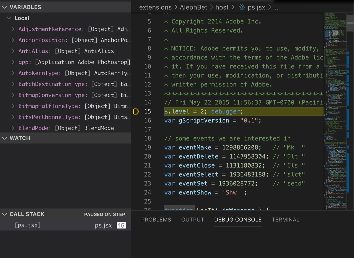

@sberic "program": "{$workspaceFolder}/PhotoshopEvents/host/ps.jsx" Thanks, that's good to know. It doesn't actually say anywhere what the configuration should point at and when I changed it, VSCode immediately started complaining again it couldn't find host/ps.jsx -- which is why I started experimenting with other configurations. However, when I restarted the whole shebang, and what with having completely uninstalled the ExtendScript Toolkit, something interesting happened:
That's the first time I've seen a variable in the debugger. Anyway, it seems there's an issue now with the debugging level -- a line I inherited from PhotoshopEvents.

e.v72938608​ The following line:
$.level = 2; debugger;
is a compressed version of this:
$.level = 2;  // Puts this ExtendScript "Engine" into Full Debug Mode.
debugger;     // Causes an attached/listening debugger to pause on this line.
The level property of the Dollar ($) object adjusts the current debugging level. A value of 2 means "full debug mode".
The debugger statement triggers the debugger.
It is important to recall that ExtendScript is a highly customized version of ECMAScript 3 (a spec from which older JavaScript versions are also derived). The debugger statement is just one of those pieces of the ExtendScript language that is shared with [older] JavaScript.
You can remove that line (or those lines as shown above) without any issue. That is simply there to drop you into a debug session if ESTK is configured (or if you have ESD setup in juuuuuust the right way).

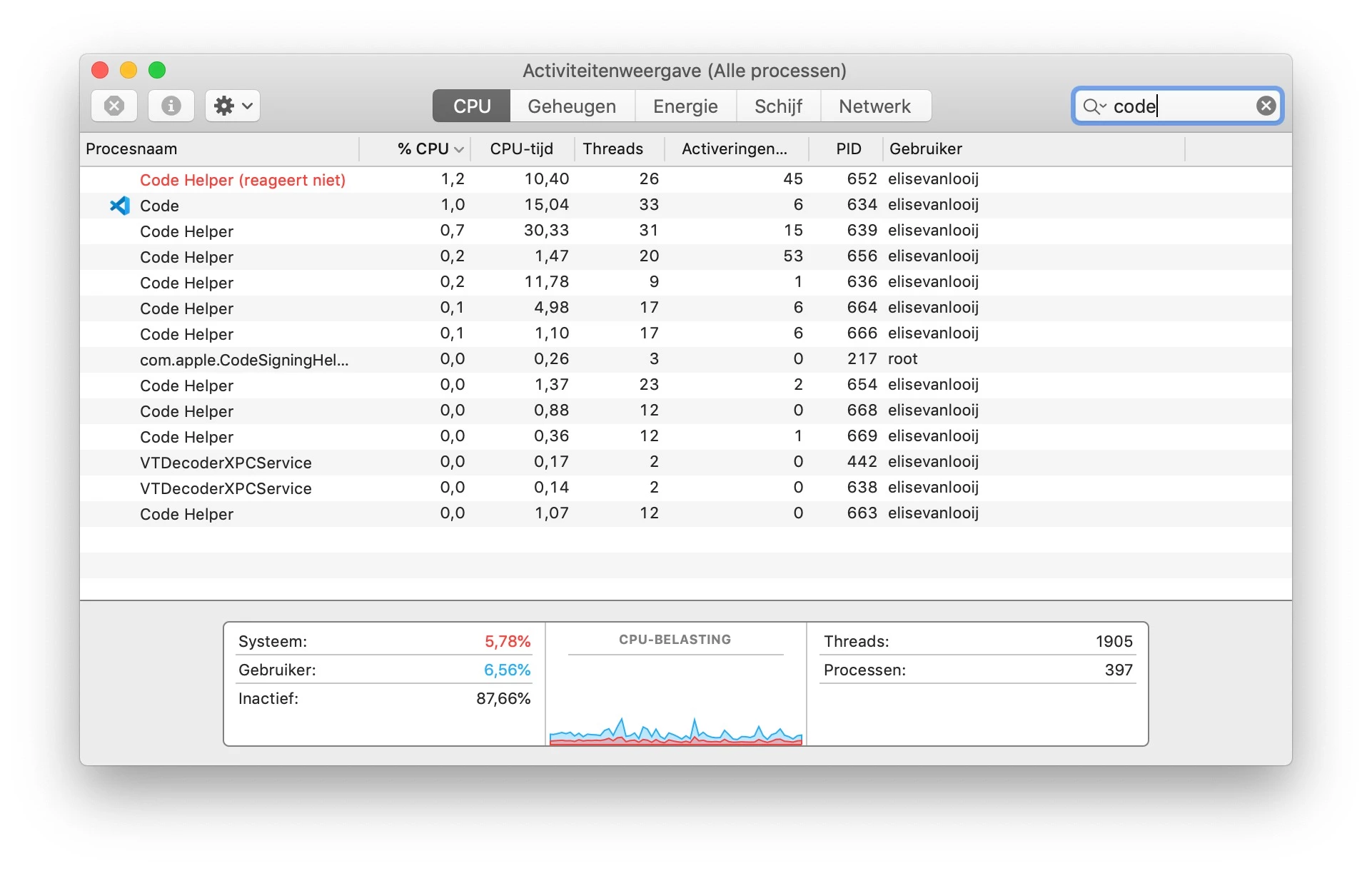

e_v72938608
August 12, 2019
@ErinF I've followed all the steps and I've uninstalled ExtendScript Toolkit, both versions, then restarted again. Unfortunately, the problems are still there. But the Activity Monitor (MacOS Mojave) did yield something of interest. When I closed Photoshop and VSCode, there was no trace of Code Helper. But when I started up VSCode (and through VSCode, Photoshop 2019),  Activity Monitor showed a lot of Code Helper instances, including one unresponsive on.
